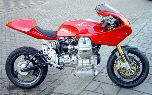

Paul Minnaert Posted December 18, 2003 Posted December 18, 2003 So here is my hollow axle picture. The mufler is gone, while I took capt. nemo sugestions to the max.
dlaing Posted December 18, 2003 Posted December 18, 2003 You should atleast put a 7 inch header on it. But damn it looks good!

Paul Minnaert Posted December 18, 2003 Posted December 18, 2003 My that transmision is from a 2001 le mans, I also have a 2000 sport trans, I have to contact the previous owner(franz) for that number. But that one is on the shelf.
Baldini Posted December 19, 2003 Posted December 19, 2003 Paul, You do not run an oil cooler? Cos w/deep sump doesn't need one? Is that Raceco part? Bike looks great. KB, Cymru
docc Posted December 19, 2003 Posted December 19, 2003 Hey, this guy is so cool he doesn't even use brake lines.
Paul Minnaert Posted December 19, 2003 Posted December 19, 2003 Who needs braking? Brake lines were to short. I have no oil cooler, only a V sump. They are made by moto special in germany, and raceco sold them too. On a track day with 35degree celcius outside, oil went up to 120 degrees.Jens Hofman from Dynotec says the V pan is good enough to skip the oil cooler. up to 140hp:-)
