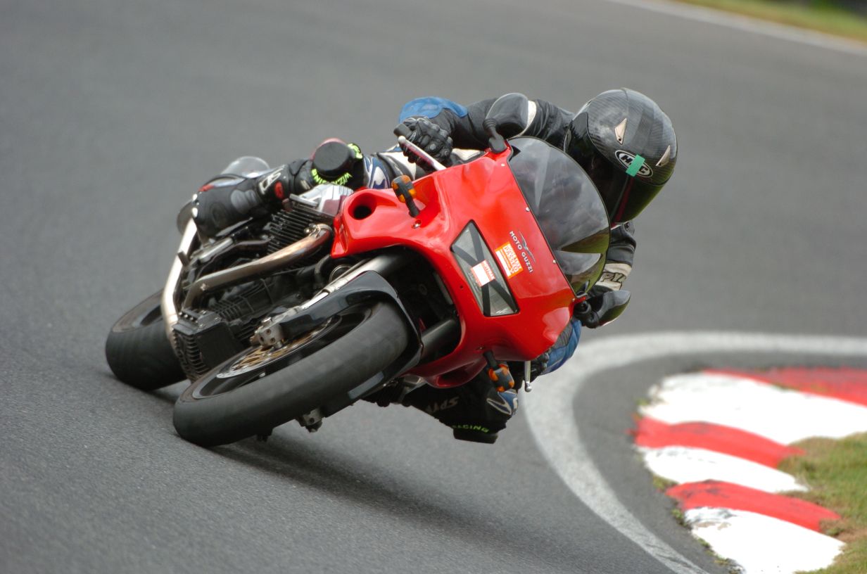

Guest gyles Posted August 31, 2007 Posted August 31, 2007 Only downside is taht the profile on the sides isn't there so you have no good wearing indicator. They should have made the small holes that slicks have. Yup - I totally agree Paul Hello Alex - thanks for the welcome. Lovely bike the Sport Corsa - I was lucky enough to have a ride on one at Cadwell a few weeks back (at the same time as the MGS01 & Raceco Daytona - well not literally at the same time The corsa is my dream 2 valve Guzzi - I have an 1100sport inj I'm building a track/race bike from. Cheers Alex - here is a pic of the Corsa (though I'm sure you have plenty)
Alex-Corsa Posted August 31, 2007 Posted August 31, 2007 Yup - I totally agree Paul Hello Alex - thanks for the welcome. Lovely bike the Sport Corsa - I was lucky enough to have a ride on one at Cadwell a few weeks back (at the same time as the MGS01 & Raceco Daytona - well not literally at the same time The corsa is my dream 2 valve Guzzi - I have an 1100sport inj I'm building a track/race bike from. Cheers Alex - here is a pic of the Corsa (though I'm sure you have plenty) Great pic over there at the track. I'm stupid enough to take it sometimes to the streets like this. If you dig into open Eproms , let me know . I have developed some of mine with the help of AFR (see first video on my sig) and a couple of other versions sold in ebay with impressions from the buyers.The temp charts are also done well so cold or hot will get just about the same AFR performance/(never done on any chip around) Love this bike looks good at any angle. Cheers

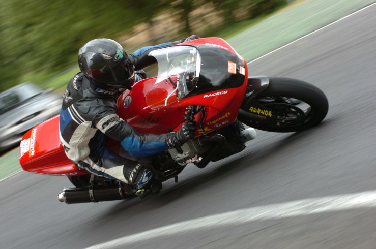

Guest gyles Posted September 4, 2007 Posted September 4, 2007 165kg is very very impressive indeed !!!!!!!! I was racing at snetterton a few months back and got my RS weighed - fully wet 215 kg !!! not sure where you managed to shed 50kg! I am really impressed. The raceco daytona got down to 169kg at its lightest. I had a ride on it a few weeks back at cadwell. 130bhp and 180kg(ish).... a lovely machine. G are you running FCR flatsides? 95 is a good solid output for a 2 valve guzzi. the RS is 106 at the rear wheel without any engine mods other than a raceco exhaust and powercommander III. maybe you could make it over to do a thunderbikes race in the UK next year? let me know if I can help at all. cheers, gyles here is the raceco daytona gyles
