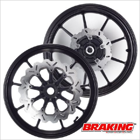

Paul Minnaert Posted September 29, 2007 Posted September 29, 2007 The breaking wheels are cheap. I have not found any weight number. I know that they can be made fitting in a guzzi, but without cush drive. If your connection could bring breaking to make a series direct fitting wheels there is a market. For that price the brake disks are included! here is the example
antonio carroccio Posted September 29, 2007 Author Posted September 29, 2007 Der Satz beinhaltet: 2 x 9 Speichen Alu-Felgen von Hersteller OZ ( vorne und hinten ) 2 x BRAKING WAVE Bremsscheiben vorne 1 x BRAKiNG WAVE Bremsscheibe hinten 1 x Aluminium Kettenrad mit modellentsprechender Originalübersetzung Ruckdämpfer und Buchsen Der komplette, einbaufertige Felgensatz hat ein Gewicht von ca. 17,5 kg ( vorne und hinten ) !! As you know Paul, my Deutsch is very, very bad, but I think is here in this specification something as a cush. Ruckdämpfer. This is a cush, or not?!
Admin Jaap Posted September 29, 2007 Posted September 29, 2007 Der Satz beinhaltet: 2 x 9 Speichen Alu-Felgen von Hersteller OZ ( vorne und hinten ) 2 x BRAKING WAVE Bremsscheiben vorne 1 x BRAKiNG WAVE Bremsscheibe hinten 1 x Aluminium Kettenrad mit modellentsprechender Originalübersetzung Ruckdämpfer und Buchsen Der komplette, einbaufertige Felgensatz hat ein Gewicht von ca. 17,5 kg ( vorne und hinten ) !! As you know Paul, my Deutsch is very, very bad, but I think is here in this specification something as a cush. Ruckdämpfer. This is a cush, or not?! The way I read it is that the "Rückdämpfer" (cush drive) comes with the rear sprocket, which we don't need... But not a bad price!

Paul Minnaert Posted September 29, 2007 Posted September 29, 2007 yes there is a cush, but thats for the chaindriven bikes. Fos a guzzi they would have to make a different wheel

Paul Minnaert Posted September 29, 2007 Posted September 29, 2007 The front wheel has a special way to mount disks. But it has road approval, so should be safe. But no other disks will fit to these wheels. http://img258.imageshack.us/img258/1697/img835io4.jpg
