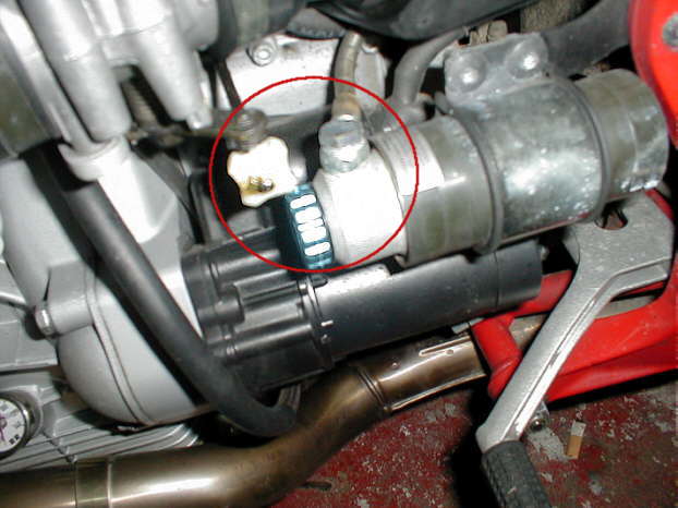

Guest jap Posted August 18, 2003 Posted August 18, 2003 hi there, On the german site (www.v11sport.de tipps) there is another scare thing to see the adjusterbolt of the linkage between the throthlebodies can get caught behind the suspension adjustment cilinder.. i am not sure if this makes sense otherwise check the site there's some pics. I am not sure if it is the same with the le mans i changed mine for a smaller one after a very interesting ride jasper 00 v11sport which is running SUPER the last couple of weeks i am really in love..
exwtk Posted August 20, 2003 Posted August 20, 2003 Hello Guzzisti, Also from v11sport.de this image of the corroded throttle shaft (righthand side) Apparently water remains standing under the throttle position sensor! I keep this cavity hole filled with lub and grease! Co from Holland
