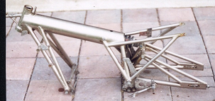

Guest ratchethack Posted November 4, 2007 Posted November 4, 2007 Greg Field said: I was just looking at an old partially disasembled IT 250 frame. It's a big spine with monoshock routed down the center of the huge spine tube. It's more alike Foale's frame than not. Same with its swingarm. I wonder who it inspired? Hmmmm. Who was zoomin' who?? Egli TZ250 frame
