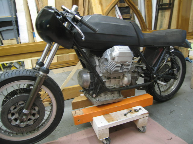

guzzijack Posted December 7, 2007 Posted December 7, 2007 The only thing i'm making lighter on my racer is my wallet. Oh yes - I guess you're going the same way as me then Current projects are V11Sport engine in LMV Tonti frame for the street and a roundfin endurance racer with chopped Tonti frame using a V11 Sport timing cover - very similar to this one: Have a good look at the V11 clutch and flywheel components as I think you may find that they are lighter than even the most radically drilled earlier 8 spring unit - check out the figures at this link on Guzzitech - not sure how much lighter than a ten spring Sporti clutch though, but maybe a bit if it's the same as my V10 one. This is a Tonti framed racer you're building isn't it? What gearbox are you using the 3 dog one from the Sporti - or something else? GJ
guzzigray Posted December 7, 2007 Author Posted December 7, 2007 Oh yes - I guess you're going the same way as me then Current projects are V11Sport engine in LMV Tonti frame for the street and a roundfin endurance racer with chopped Tonti frame using a V11 Sport timing cover - very similar to this one: Have a good look at the V11 clutch and flywheel components as I think you may find that they are lighter than even the most radically drilled earlier 8 spring unit - check out the figures at this link on Guzzitech - not sure how much lighter than a ten spring Sporti clutch though, but maybe a bit if it's the same as my V10 one. This is a Tonti framed racer you're building isn't it? What gearbox are you using the 3 dog one from the Sporti - or something else? GJ Wow!! 2 bikes. I thought i was crazy I'm going to use the 10 spring Sport 1100 clutch. Haven't weighed it but it's about as light as a lightened stock 8 springer. I've had a Ram clutch in my street bike and i'm not crazy about them and apparently the newer ones which i think are used in some V11's aren't that great either (or light). Don't quote me on that though!! I'm using a Lemans1/T-3 gearbox and yes it's a Tonti frame i'm using.
