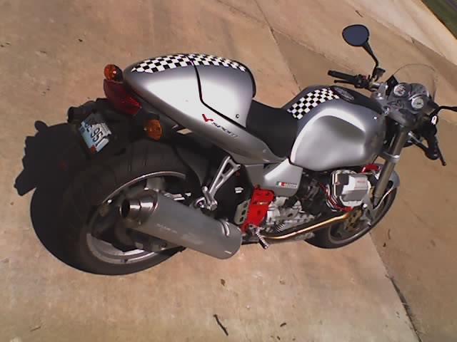

Guest geno929 Posted March 13, 2008 Share Posted March 13, 2008 Congrats on the new V11 Sport in that fantastic color! The key to good handeling with the V11 is a 160 rear and proper tire pressures. I have Dunlop Qualifiers in 160 width and run at 36 - 38 psi. Also you will have to move a bit to get the most out of this bike. It kind of wiggles around in the corners. I feel it is frame flex. You being used to a VFR with a perimiter frame won't be used to the flexing of the V11. Good luck! Link to comment Share on other sites More sharing options...
