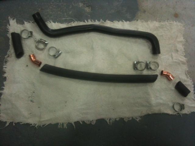

Guest ratchethack Posted August 30, 2005 Share Posted August 30, 2005 Keep looking, Nog. You'll need to find it when it starts leaking (and it will). It runs from just in front of the clutch housing on the top rear of the engine case to just aft of the steering head on the underside of the frame. Link to comment Share on other sites More sharing options...
bigbikerrick Posted August 30, 2005 Share Posted August 30, 2005 I guess this hose is only found on "ecochondriac" American market bikes. I can't find anything like that on mine! 58977[/snapback] I dont believe the hose is an emission control hose, it is for crankcase pressure venting/breathing,which all motors must have. take another look , it starts on top of the motor case right in front of the gearbox/ bellhousing. It looks like a cracked black garden hose( at least in my case its cracked!) 1 Link to comment Share on other sites More sharing options...
Guest Nogbad Posted August 30, 2005 Share Posted August 30, 2005 I dont believe the hose is an emission control hose, it is for crankcase pressure venting/breathing,which all motors must have. take another look , it starts on top of the motor case right in front of the gearbox/ bellhousing. It looks like a cracked black garden hose( at least in my case its cracked!) 58980[/snapback] AAAAGGGGHHH NOOOOOOOO! I've found it and it's CRACKED where it fits over the stub on the crankcase. I HATE YOU ALL!!! Link to comment Share on other sites More sharing options...
bigbikerrick Posted August 30, 2005 Share Posted August 30, 2005 AAAAGGGGHHH NOOOOOOOO! I've found it and it's CRACKED where it fits over the stub on the crankcase. I HATE YOU ALL!!! 58982[/snapback] See, you learn something new every day! Dont be upset Its a 1 to 2 beer job, Ill buy the ale! Link to comment Share on other sites More sharing options...
Guest Nogbad Posted August 30, 2005 Share Posted August 30, 2005 See, you learn something new every day! Dont be upset Its a 1 to 2 beer job, Ill buy the ale! 58984[/snapback] The rubber bits on this Guzzi seem to suffer badly from cracking and degredation just like the MZ I used to ride. On the MZ I assumed that was simply down to commies not having any incentive to use either good quality polymers or make 'em right if they did have decent rubber. What's with the crap rubber on a western (EU) made product then????? Link to comment Share on other sites More sharing options...
dlaing Posted August 31, 2005 Author Share Posted August 31, 2005 Did you use the ford hose with the 2 curved ends ,or the dayco hose with one straight end on your sport? Im getting ready to replace my cracked one..... The bikes hose that is.... 58959[/snapback] I went with the Ford hose. I can't describe how I trimmed it, because I cannot remember, but I did trim it. All I know is that this hose needs trim. It was a bit tighter to squeeze on than the 3/4 inch ID heater hose, but so far, so good! PS Nogbad, just be happy the hose did not explode 100 miles from home. I know, you hate me.... Link to comment Share on other sites More sharing options...
dlaing Posted August 31, 2005 Author Share Posted August 31, 2005 What's with the crap rubber on a western (EU) made product then????? 58990[/snapback] FWIW I think that hose is made of vinyl. Pure crap for its intended purpose, but I guess it is easier to mold that the reinforced black rubber hoses. Link to comment Share on other sites More sharing options...
Guest Nogbad Posted August 31, 2005 Share Posted August 31, 2005 Mine seems to be rubber. Doesn't feel like vinyl. I guess I'll buy an OEM one and hope it degrades with age rather than mileage. Almost 5 years isn't so bad I suppose. Link to comment Share on other sites More sharing options...
Distilled Waters Run Deep Posted September 19, 2008 Share Posted September 19, 2008 Does anyone know if copper is ok for the bends? In UK water pipes are either 13mm or 22mm o/s diameter. 22 may sound a lot for 19mm rubber, but a squirt of maintenance spray & it slips on nice & snug. I wonder if the PE push-fit type materials are suitable? Wire spring clips of about the right diameter are used for washing machine waste pipes. If there's a mod watching, it may be worth updating earlier posts -I got excited and almost went out to get pvc bends without reading on... Link to comment Share on other sites More sharing options...
LaurentG Posted April 15, 2013 Share Posted April 15, 2013 It's year later and this post is still serving us well. I installed the 3/4inch hose with 1/2" copper elbows today. Great fit.Thanks guys! 1 Link to comment Share on other sites More sharing options...
