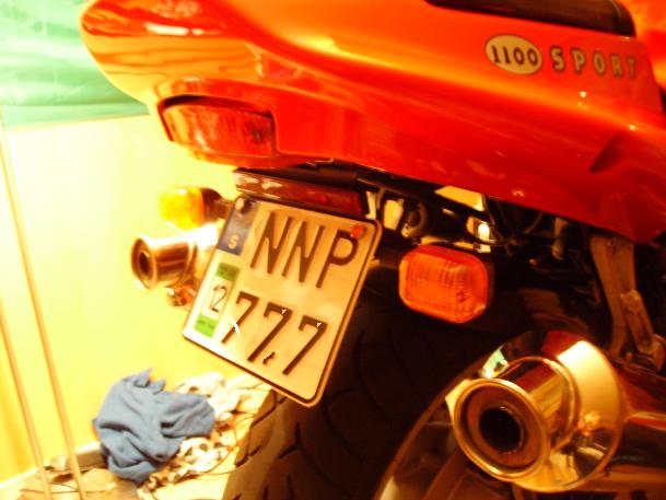

raz Posted March 27, 2008 Posted March 27, 2008 I bought a CF hugger from Stein-Dinse in Germany. I don't like CF and it was damn expensive (about 200 euro IIRC) but they couldn't deliver the plastic one. Even the CF one took half a year to deliver. Then I bought a black plate bracket that was made for some kind of Suzuki or something. Amazingly it happened to have holes fitting everything: Four holes for mounting to existing screws, the indicators fit to it, and even the reflector between the plate and the tail light fit without drilling. The original plate light works as intended. It's like it is made for this, except the angle of the plate was too upright so I had to fix that with small bits of a pipe cut in an angle and used as washers behind the plate. My english limits a better description I kept the OEM rear fender but cut away all of it that was visible. This way it still protects the bottom of the rear section. The result is just perfect, in my own opinion . A friend of mine found the plate bracket so he gets the credit for that. He didn't keep the original fender but used some sort of rubber mat tied up to the rear sub frame. I'll try to produce some pictures.

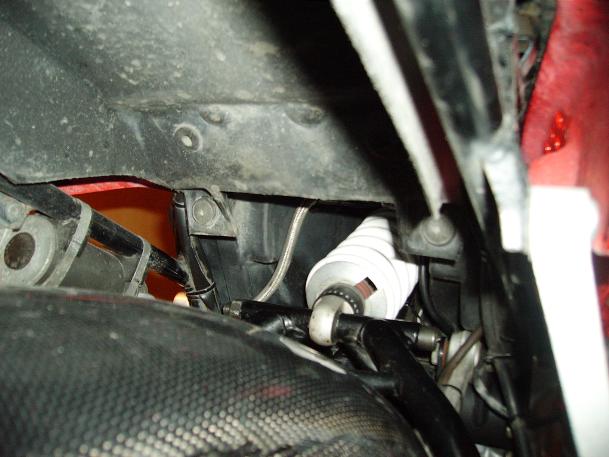

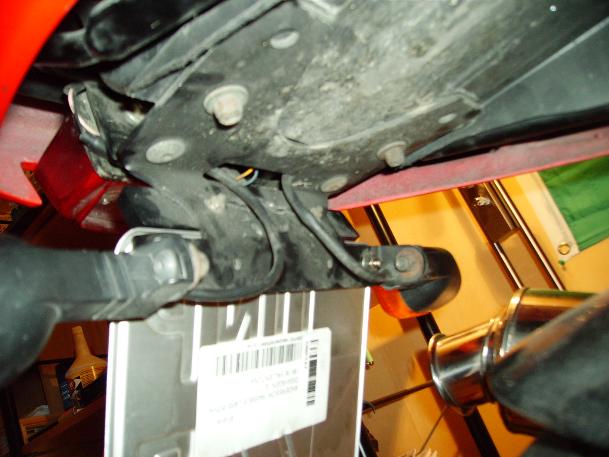

raz Posted March 27, 2008 Posted March 27, 2008 This is with hugger and ugly OEM fender. This is after fender is cut down to invisible. Hard to see, er, but there is nothing to see! It's just gone. Reflector, indicators, plate light just fits like it was OEM (personally I don't like tiny LED indicators). I photochopped[tm] the registration number a little in this pic All mounting holes in this Suzuki bracket just happened to fit! Here you can see my not very straight cut of the fender, but it can't be seen at all from normal angles. I cut it down just so the original mounts was still there. Note the triangular area where the damper satellite is mounted, that hole being opened makes a lot to the bikes look! Not so much from this particular angle though
JFK Posted March 28, 2008 Author Posted March 28, 2008 This is with hugger and ugly OEM fender. This is after fender is cut down to invisible. Hard to see, er, but there is nothing to see! It's just gone. Reflector, indicators, plate light just fits like it was OEM (personally I don't like tiny LED indicators). I photochopped[tm] the registration number a little in this pic All mounting holes in this Suzuki bracket just happened to fit! Here you can see my not very straight cut of the fender, but it can't be seen at all from normal angles. I cut it down just so the original mounts was still there. Hi Raz Thanks heaps for the pics ... looks great! Not sure I want to cut up the original fender though I'm going to look into Greg's units (above), and have a think about alternatives for the fender. JFK

rocker59 Posted March 28, 2008 Posted March 28, 2008 I'd sure like to know the part number of model of bike that bracket came from. That is the cleanest Sport 1100 rear fender mod I've ever seen !!! I'd do mine if I could find that light mounting bracket !!!
raz Posted March 30, 2008 Posted March 30, 2008 I'd sure like to know the part number of model of bike that bracket came from. That is the cleanest Sport 1100 rear fender mod I've ever seen !!! I'd do mine if I could find that light mounting bracket !!! Hey, I found the receipt, it says GSX600R/750R 2004-2005. But it is aftermarket, I don't know more than that. It MAY be made by a company called Kellermann. I do have a part number but that is just for this local distributor in Sweden. Anyway maybe that will get you started. The bolt holes that fit to the tool tray and rearmost fender mounts/tail light should be OK even if you find a slightly different product, I guess. The plate holder came with an additional X bracket that supports the whole plate but it was too large for our stylish Swedish plates and as you see in the picture my plate is fine with just the upper mounts. Edit: Doesn't seem to be Kellermann, their's is here but it doesn't look like mine at all.
