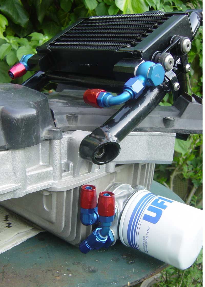

Paul Minnaert Posted May 10, 2008 Posted May 10, 2008 I don't know the sidestand problem. I have a v11 sidestand on my bike. With V sump. Yes it only mounts on the big screw, but that one holds it for 4 years now. And to get an oilcooler on my bike, I just got some parts in, look at the picture. And moto Spezial is still making parts, only not supplying all aftermarket and Guzziparts from others anymore. THe owner stripped it down to a one person operation.

DeBenGuzzi Posted May 11, 2008 Posted May 11, 2008 I don't know the sidestand problem. I have a v11 sidestand on my bike. With V sump. Yes it only mounts on the big screw, but that one holds it for 4 years now. And to get an oilcooler on my bike, I just got some parts in, look at the picture. And moto Spezial is still making parts, only not supplying all aftermarket and Guzziparts from others anymore. THe owner stripped it down to a one person operation. I like pauls solution, tho I wish I had half his money and/or dedication to pull it off. The man can tinker
dabore84 Posted May 15, 2008 Posted May 15, 2008 I like pauls solution, tho I wish I had half his money and/or dedication to pull it off. The man can tinker I don't get it. I see oil cooler, filter and ??? Paul, could you explain a little more. thx
Paul Minnaert Posted May 15, 2008 Posted May 15, 2008 well these were the parts, so I could take them to the shop to get the right banjos. mounted it looks like this:
DeBenGuzzi Posted May 16, 2008 Posted May 16, 2008 well these were the parts, so I could take them to the shop to get the right banjos. mounted it looks like this: that looks how it should have come stock, or at least with a windage sheet to avoid oil starvation, I like pauls extermemly expensive over engineered approach, 60% of the time it works everytime
