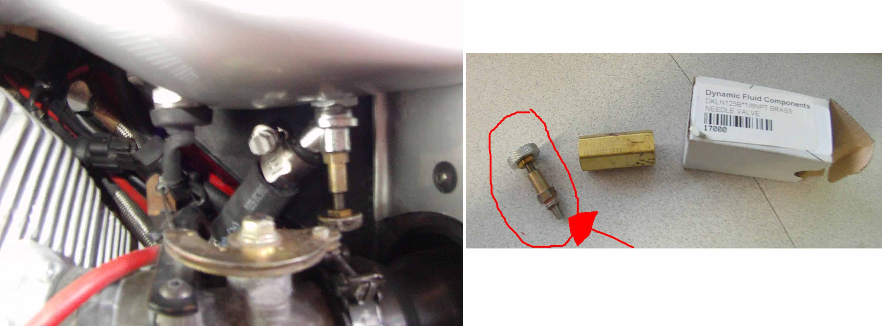

adam211minn Posted May 24, 2011 Posted May 24, 2011 On 5/21/2008 at 8:10 PM, Velf 2003 said: Hi all, I too suffered from this problem. It is true that the pump will suck open the fuel petcock even is it isn`t powered by a broken wire on a electric petcock. The sound the pump will give then isn`t the normal sound but higher, asmatic. The hotter the temperature of the air, and therefore the engine, the worse the engine will run and finally it will stall. Took some 45 minutes to let it cool down and start all over again to warm up when it would restart. I solved the problem by resoldering the broken wire back on. It now survived 30.000 km.... Good luck!! Velf2003 I wish I would have found this sooner!! This is the exact problem I was experiencing for a whole summer. It seemed to happen mostly on hot days, so I suspected vapor lock. As soon as I let the engine cool for 30 - 40mins it would restart and run fine. But the hole time it was a broken wire on the fuel tap solenoid. The wire shielding was still slightly connected so it look as though it was fine, however inside the wires were broken. So I temporarily fixed it by removing the o-ring on the solenoid, which worked. However I was worried that it might still be limiting my fuel flow and if I needed to take the tank off it would run gas every where. So I needed a manual fuel tap, but I didn’t even consider going to my deal because they are pretty worthless and never have a clue what they are talking about. Instead I amazingly found this little hydraulic needle valve (dynamic fluid components, p/n DKLN125N*1/8NPT brass needle valve), that once unthreaded from its housing threads perfectly into the v11 fuel tap!!! I did however have to turn a little radius on the tip of the needle to hold the o-ring, I used a machinist lathe, but you could do the same thing with a dremil if you have steady hands. I also used a little tread sealant on the threads just to make sure it would not leak and all my problems are solved, no more vapor lock issues and I now have a manual fuel tap/ petcock.

Marc Morrison Posted January 10, 2022 Posted January 10, 2022 To adam211minn.....I normally keep up with MG topics in WildGuzzi, but I was interested in your posting from several years ago concerning your fix for leaking petcocks. I know it's been a long time since you posted your fix, however, if you still post on this forum and you could provide me with a source for the Dynamic Fluid Component needle valve you used for this project (DKLN125b), it would be greatly appreciated. My electric fuel tap has given up and a manual unit I purchased from MGCycle 2 years ago has started leaking. Thx...Marc Morrison, Kerrville, TX 1
