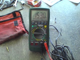

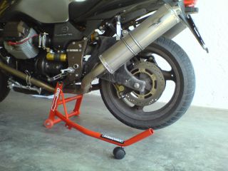

v11cafe Posted July 8, 2008 Author Posted July 8, 2008 Poor man.... tuner tools 1/Don't know why but V11 behaves better tuning it on center stand....doesn't like side stand Third wheel from old office chair...saw it somewhere in the forum ...good idea 2/Polymeter...including Voltmeter 3/Twinmax....or any throttle balancer 4/Simple 2.5mm hex key for LITS 5/Connection of two outer tps wires to voltmeter 6/7/tool...for RITS if following cat method
Dimitris Posted July 8, 2008 Posted July 8, 2008 Fine pics! Thank you! I will surely follow the method, when I have the bike back..
dlaing Posted July 9, 2008 Posted July 9, 2008 2/Polymeter...including Voltmeter I believe that in most English speaking countries we call it a multimeter, not polymeter. Of course poly and multi mean essentially the same thing. Here is a definition of polymeter: http://en.wikipedia.org/wiki/Meter_(music)#Polymeter and multimeter: http://en.wiktionary.org/wiki/multimeter By the way, nice photos!
