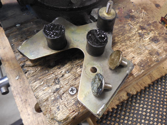

Thunderpaugh Posted May 28, 2008 Posted May 28, 2008 For my V11 Lemans, the vibration isolators for the ignition coil mounting bracket have failed. All three have sheared off the metal plates that attach it to the frame, leaving the coils and bracket and the remainder of the vibration isolators to float in the nest of hoses and wires under the tank inside the frame, and the metal plates bolted to the frame tabs. Has anyone seen this type of failure before? Can the isolators be repaired by re-adhering the metal plates to the rubber, and if so, with what adhesive? Are new isolators readily available from Guzzi dealers?
twhitaker Posted May 28, 2008 Posted May 28, 2008 They are available and not expensive. I've successfully glued them back together using a polyurethane glue.

renato Posted June 2, 2008 Posted June 2, 2008 moto guzzi seems to keep parts on the shelf for long periods and when rubber parts have been shelfed for to long it tends to fail as with my 03 sport (coil braket n more) not long after i purchased it new. but once replaced i have not had any problem. ive also found vibration dampers from a 91 h.d. sportster oil tank mount are larger, stronger,cheaper and fit just right, sorry i dont have the part number with me
raz Posted June 2, 2008 Posted June 2, 2008 I bought Guzzi OEM, they were not cheap, some $20 each IIRC. If I find a cheaper alternative I'll buy a dozen.
Tom M Posted June 2, 2008 Posted June 2, 2008 I bought Guzzi OEM, they were not cheap, some $20 each IIRC. If I find a cheaper alternative I'll buy a dozen. I know nothing about this company or their mounts but they look about right and they're a lot cheaper than $20. They might work for the instrument panel too. I don't know if the Guzzi mounts are 20mm though. http://www.touratech-usa.com/shop/show.las...22B1EnQP3FE1553
docc Posted March 1, 2014 Posted March 1, 2014 The Touratech pieces are currently $10US each plus shipping. I found two out of the three coil mounts separated and repaired them by cleaning the metal part on a wire wheel, prepping both sides with a solvent and securing them with a high strength contact adhesive (Shoe Goo or Goop). Others have used "SuperGlue" (cyanoacrylate) , or other adhesives.
OldButNotDead Posted March 1, 2014 Posted March 1, 2014 Got me some replacements here: http://vibrationmounts.com/Store.asp?Page=Products1.htm Found some in "Metric - cylindrical to 713kgf"
docc Posted March 2, 2014 Posted March 2, 2014 Neat - I'll add that link to the Tank Off Maintenance Checklist. Looks like they would also have the smaller ones used for the ECU (I had to repair two of those also).
