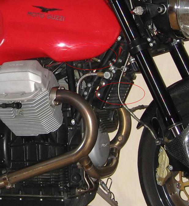

dabore84 Posted May 30, 2008 Share Posted May 30, 2008 I rode my bike this morning in the rain, going to my work. 10 miles highway, then 5 miles trough the city. In the city, when I was waiting for the green light, suddnley I saw smoke comming, or from my oil cooler or from somewhere above my cooler. It scared the shit out of me, cause I didnt know where it exactly came from. There is no oil leaking or something like that. I didnt ride in the rain before, third time on the bike. Here is a old pic. Yesterday I didnt saw any smoke and it also rained. Plzzz help. Could I ride home safely? Link to comment Share on other sites More sharing options...

luhbo Posted May 30, 2008 Share Posted May 30, 2008 I'm quite sure that it was only water resp. steam/vapor. The difference to smoke is, that once the smoke is out, something has quit working. Nevertheless, you could check the yellow cables coming out of the alternator. These end in rather cheap connectors somewhere below the stearing head, way too cheap for the load they have to bear. I could think of a scenario, where rain, mud and heavy amps could drive them right over their limits. So it could have been smoke as well, unfortunately. Check them. Hubert Link to comment Share on other sites More sharing options...

dabore84 Posted May 30, 2008 Author Share Posted May 30, 2008 Good news, it was only water. When I rode back home, everything was oke. No smoke, nothing. I'm little confused, that I didnt noticed it yesterday. Ok, I am a happy boy again. Thanks for feedback. Gonna check those cables. What kind of grease is used for electronic parts, to protect it from moisture? Link to comment Share on other sites More sharing options...
