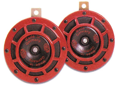

Keith Foster Posted June 15, 2008 Posted June 15, 2008 FalcoLion, I've had the same idea too. I've seen this set of horns in Griots Garage catalog for a while now and thought they would look good on the Nero. They are also available here ($65.00), along with specs, etc: Hella horn These draw 6 amps per the specs. The stock horns are 3" in diameter, these are nearly 4 7/8", so mounting them in the stock location probably would not happen. Maybe drawing half the amps a relay could be avoided.
