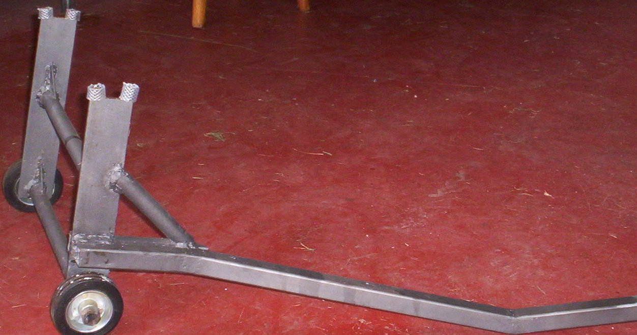

gavo Posted May 27, 2009 Posted May 27, 2009 Home made version of one viewed here. srap steel and wheels in shed,2 hours work and hey presto bigger wheels help it to roll easier, haven't found a need for one on the handle. Its rock solid and a good balance point between front and rear

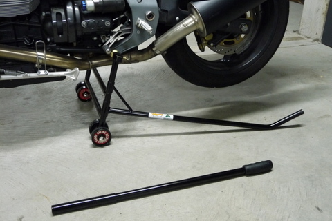

Mikuzzi Posted August 20, 2009 Posted August 20, 2009 Had this stand made up locally - variation of the OEM stand. The arm swings through greater than 180 degrees so it will hang flat from a hook on the wall and can have the arm either side of the bike. The removable arm extension gives good extra mechanical advantage and makes life a bit easier on the now, er.. not so young, back and arms. Great quality job.
