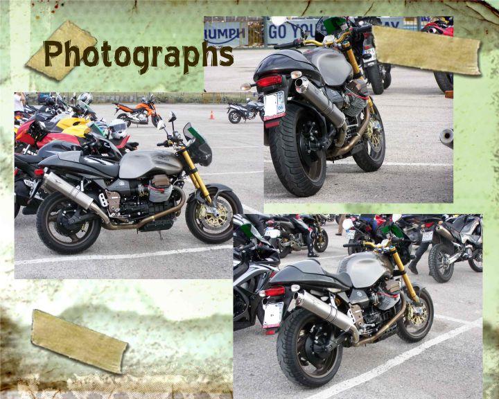

v11cafe Posted July 27, 2008 Posted July 27, 2008 I have Ti kit on my 2004 cafe sport....kit consists of 1/two cans 2/Ti ecu 3/two short pipes ( from can to crossover) 4/two shorter hangers What I like is: Good quality...well made Cans weight a lot less than the stock You don't get burned anymore (big temperature diff) MG logos/looks Sound ....nice and not annoying Easy to install you have to be careful since there are two Ti kit available one 2000-2002...and another for later bikes Performance improves not much in low range. but you feel difference from 5000-7000 only sound ....gives you at least 5hp Passenger foot pegs are higher,... not very good for tall people at the back seat. Tuning remains standard like every V11, but to avoid some part throttle pop/baf etc(1000-3000rpm) you have to adjust trim level at 4% to 5% CO...the Ti ecu has a different fuel and timing map

raceboy Posted July 27, 2008 Author Posted July 27, 2008 Hello V11cafe, Your bike looks great. Thanks for your input. I have a few questions. Do you have the part number for the Factory MG Ti Kit for the 2004 bikes?? Is the ECU that comes with the kit able to be reprogrammed / flashed with a new map or is it similar to the Stock unit....closed?? What cross over did you use??? I plan on using my bike for track days once in a while. Have you taken you bike on the track and how does it work on the track?? Thanks, Raceboy I have Ti kit on my 2004 cafe sport....kit consists of1/two cans 2/Ti ecu 3/two short pipes ( from can to crossover) 4/two shorter hangers What I like is: Good quality...well made Cans weight a lot less than the stock You don't get burned anymore (big temperature diff) MG logos/looks Sound ....nice and not annoying Easy to install you have to be careful since there are two Ti kit available one 2000-2002...and another for later bikes Performance improves not much in low range. but you feel difference from 5000-7000 only sound ....gives you at least 5hp Passenger foot pegs are higher,... not very good for tall people at the back seat. Tuning remains standard like every V11, but to avoid some part throttle pop/baf etc(1000-3000rpm) you have to adjust trim level at 4% to 5% CO...the Ti ecu has a different fuel and timing map
v11cafe Posted July 28, 2008 Posted July 28, 2008 1/I bought Ti kit from TLM Holland....I have no part number http://www.tlm.nl/ 2/No...exactly like the standard..flashed by the factory with Ti map 3/I have the stock cross over...but I plan for the Stucchi...gives something more 5000/7000rpm 4/Works better in small tracks with many curves.. u can keep up with 600 4 cyl Japs only bad thing the handlebars...don't help much when u lean out of the bike
