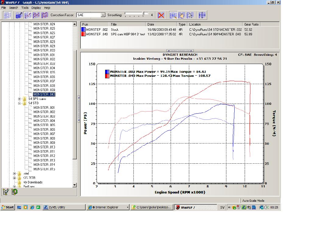

vij Posted May 2, 2009 Posted May 2, 2009 What bike are we talking about? I assume one of the dukes. Will you be running closed loop? It is a Ducati 851. Engine has been replaced with an upgraded 996 engine and the Wiring and ECU has been replaced with Ducati 916 stuff so the original P7 ECU has been replaced with a P16. I will run open loop. I dont see any reason to run closed loop. It is just a question to do the mapping right as always and I dont see any difference in mapping a MyECU to any other ECU. It is just mapping after all. I can ofcourse be wrong as always as I have no experience of running closed loop. Here is a dynorun of my latest creation. It is a slightly tuned Monster S4. Here seen in a de-tuned version as I am running out of fuel over 8000RPM and had to detune a bit. It is most probably 5hk more to get on top when I put it back the cam timing to what I want and when I increase the fuel pressure Jocke........
