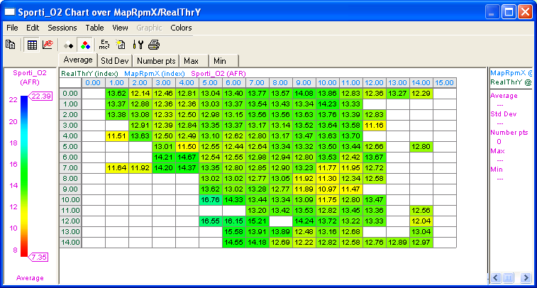

raz Posted September 27, 2009 Author Posted September 27, 2009 The MyECU plugin for Logworks (as well as a GPS plugin) is now downloadable from http://www.abc.se/~rasmus/logworks/ optionally with full source code. Logworks offers endless possibilities for reading your log data. It can even be used to calculate a whole new map for you or simulate a dyno graph (with hp calculated from acceleration). Download it from here: http://www.innovatem...com/support.php Here is an example. I rode for some 45 minutes, then with a few maneuvers I produced this map of actual O2 by map cell. Note that it's upside-down, the WOT row is at the bottom.
