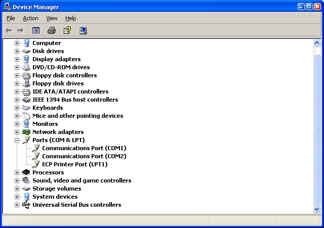

I got My15m up and running. Everything works fine, optimizer etc. I tried to use a usb 2 serial adaptor to connect to my laptop but no communication was ever established. Yes I have the driver installed and under the assumption that the usb 2 serial cable works, it is brand new. I can communicate with the ECU using an older computer with a serial connection, so the serial interface is good. Anyone here sucessfully use a usb 2 serial and am I missing something simple.
Make sure the ECUcontrol is set to the correct Com port number as it defaults to Com 1 and your USB 2 Serial may not be 1(mine is 4)!!
My laptop is in the garage so the Device Manager pic is from my PC so no USB serial !!!

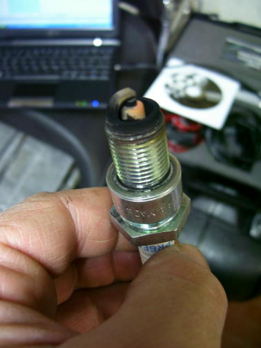

Compared w the Cali2 map I have from Cliff you are running quite rich, like 20-25% too much overall.
Maybe it simply chokes from too much fuel when you apply thottle?
How does your plugs look?

tank for answer,yes,the map is more rich,first i try the map i have from Cliff,this should be a lean to my bike,i made
this new map with closed loop and LC1 module,the setting is 2.00V in the cell 01.
Maybe your idea about the chokings is right,i want to try if the bike sound better
Yes,the break throttle and RPM look different,this come from a Cali special sport map that Cliff send me,the map is a
disaster on my bike,but i want to try a different settings from a people more experienced than me,now i set again my
older breaks i set before whit the triks of Raz,the bike work too much better!!
Your and other helph is welcomed,tanks Greenmonster
