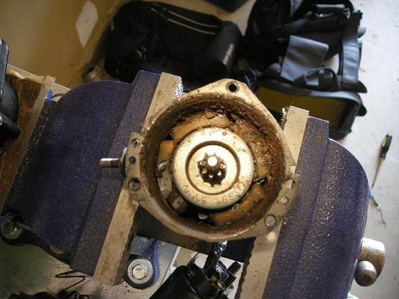

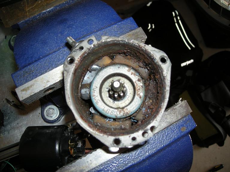

wheelsucker Posted October 10, 2008 Author Posted October 10, 2008 So after all this trouble, I redid my starter brushes, got the new battery. Turns out my starter is trashed. The first clue was when I took off the back cover of the starter there was a bunch of gunk that looked like red clay. Now I have completely disassembled the starter and found the two of the magnets inside the starter broke in half. So it looks like I'll be buying a new starter...at least I have a new set of brushes:) Pics of trashed magnets attached, on one of the pictures where I'm holding the gears, you can see some of the magnet fragments covering the housing.
