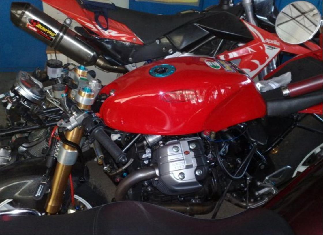

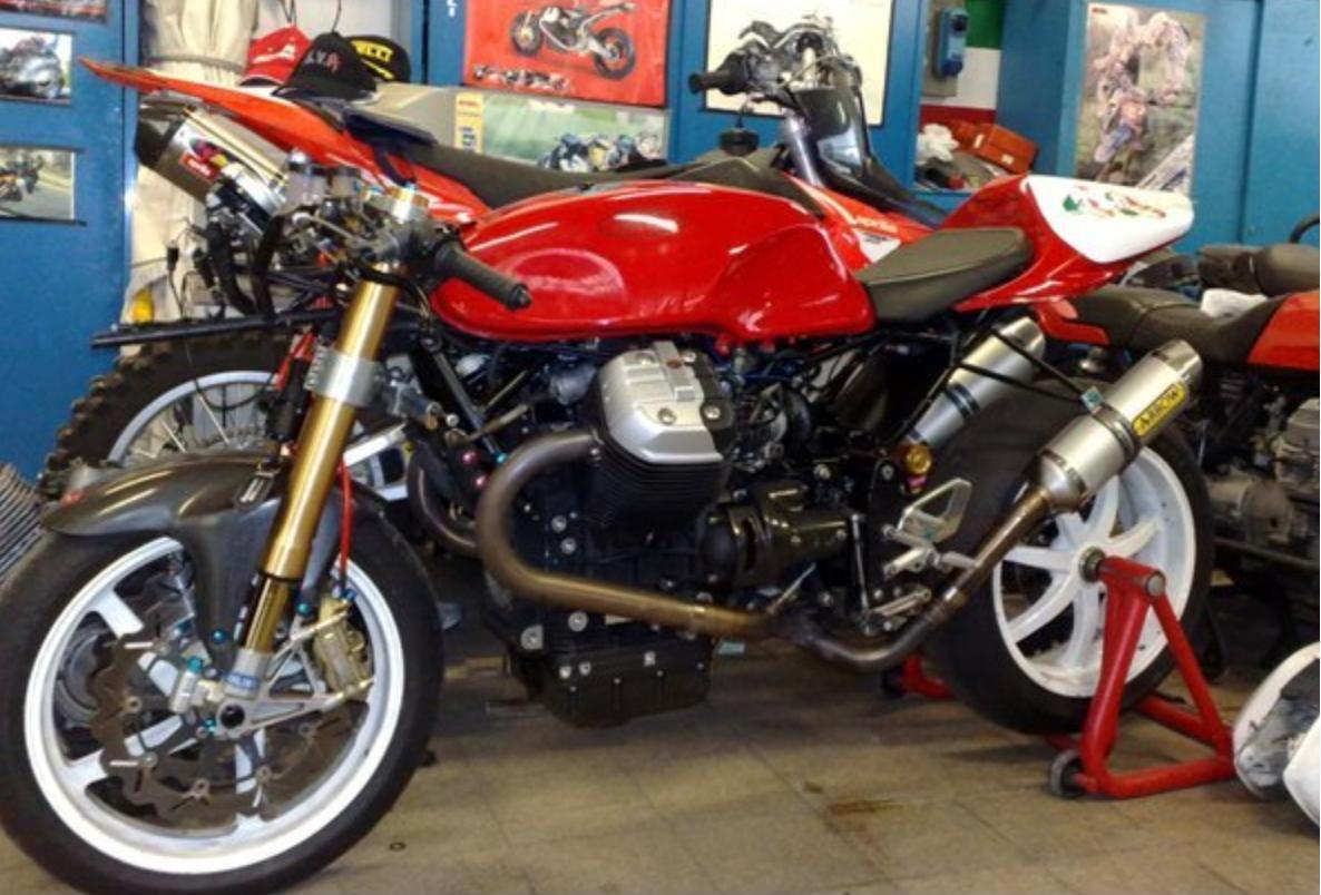

Paul Minnaert Posted October 18, 2008 Posted October 18, 2008 it's not that a traditional swingarm is impossible for Guzzi to make, they won't do it I think. The new 8v engine gives a colision between frame and alternator when fitted to the v11/mgs01 frame. However when you want to diy one yourself, it is possible, see the result here, v11 frame, modified other very small alternator rsv factory forks 8v engine Carc This could be done more easy with v11 gearbox and rear. Made by CP racing Roma :
hoytstaab Posted October 18, 2008 Posted October 18, 2008 Thanks, Paul. It would be nice for the factory to engineer a new frame that has very similar geometry as the MGS-01 (wheelbase, rake, trail) and mate it to the new motor. The hp and torque are now there from the factory, just complete the deal with a chassis. (and scrap the breva styling when it comes to the sport model line....the Breva is good for its intended purpose)
