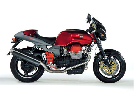

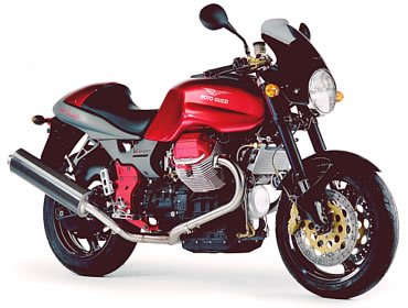

Paul Minnaert Posted October 11, 2008 Posted October 11, 2008 theis is what it should look like. They are basicaly a v11 sport first series, with single plate clutch, black frame and engine, and cf cans. I think they had a number on the triple clamp. Suspension is marcochi/sachs
richard100t Posted October 11, 2008 Posted October 11, 2008 Someone had started a thread in here years ago with a lot of the Rosso Mandello frame numbers in it. I remember because mine was there. There is no number on the triple clamp, the side panels are plastic & they do have a number on them. If yours isnt a "numbered" Rosso Mandello it will have a little flag logo where the number logo would be. Aside from the single plate clutch its mechanically the same bike as the rest of the red frame v11's. The exhaust is the same standard exhaust as the rest but wrapped in carbon fiber to give a sportier look.

todd haven Posted October 13, 2008 Posted October 13, 2008 Rossos had black fork legs and black headlight ears. Easy vsual tip-off. Correct on the 300 numbered, 300 un-numbered.
