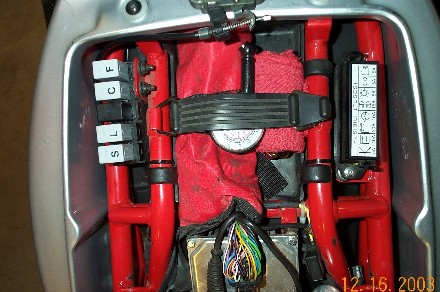

Kiwi Dave Posted December 16, 2003 Posted December 16, 2003 On my 2002 Le Mans, I checked the wiring diagram against the colour codes going in to the relays and found the following:- Counting from the front, 1. Start Relay 2. Lights Relay 3. Sidestand Relay 4. ECU Relay 5. Injector Relay Now, I gotta work out some way of labelling these .....
docc Posted December 16, 2003 Posted December 16, 2003 Vinyl stick on letters from the hobby store. "S", start; " L", lights; "C", computer; "F", fuel. The black one is an upgraded Siemans which I put in the "side stand relay" slot as it is the least stressed. It is actually activated by the neautral switch not the side stand switch. I put a couple of the original Siemans in a bubble bag and slid them into the tail cowl storage just in case . . . I measured voltages today: 12.72 v at rest, 13.0 after running a few minutes at idle and 13.98 v at 1800 rpm and up. This means the 60 watt hi beam will draw less amperage than it would at 12.0 volts ( 4.3 amps versus 5 amps at 12.0 volts). Less current is good news.

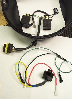

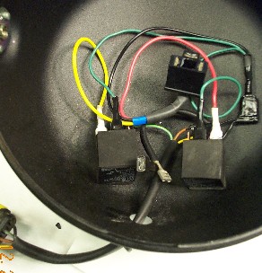

docc Posted December 21, 2003 Posted December 21, 2003 The AMP connnector for the headlamp can be opened and the individual connectors fastened to the relays ( these are 30 amp), one each for the hi and low beam. They will fit in the headlamp shell but I padded them with a thin sheet of closed cell foam to avoid damaging the back of the reflector. Now to run a 16 guage hot from the battery. I'm working on a junction block to get that stack of terminals off the battery. More on that tlater. Here's a photo of the harness modification :
Kiwi Dave Posted December 21, 2003 Posted December 21, 2003 I'd be curious to know whether the addition of the relays for the lighting circuits significantly increases the amount of light output from the headlight. Any chance of measuring before and after, docc?
docc Posted December 22, 2003 Posted December 22, 2003 The only meaningful measure I could think to use is ' voltage drop.' I guess I could point the thing at the garage door and do a 'before and after' like the link we saw. i'm not expecting a brighter light(would be nice though) just hoping to enhance reliability and preserve my switches. Spaghetti in a bucket:

docc Posted December 24, 2003 Posted December 24, 2003 Dave, WOW! Those lights are bright! And the horns are loud , too. Of course doing this in the garage kind of skews the impressions. The actual voltage drop at the headlight connector is half . But since the original voltage drop was 0.7 % this should add up to a whopping 1/2 watt increase in the lamp. I really don't think the light's any brighter. But I did put a 5 amp fuse in the main block for the headlamp circuit ( it was a 15 amp) so I'm still hoping to save any relay or switch failure in the long run. So far no smoke to try and get back in the wires.
dlaing Posted December 24, 2003 Author Posted December 24, 2003 Smokin'! Maybe if you ran the lighting through Nology plug wires they'd shine brighter I like your junction boxes. Are those standard radio shack issue? If you hold the high beam flash on, (so that the low and high beams are both on and you are pushing maybe 9 amps)does it blow the 5 amp fuse?
