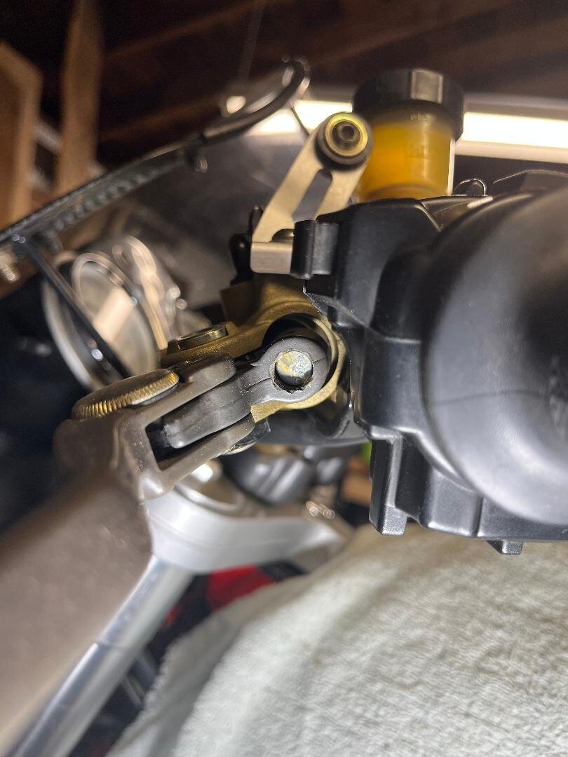

deadpen69 Posted July 9, 2023 Posted July 9, 2023 On 7/4/2023 at 8:43 PM, docc said: Yep. With fluid in the reservoir, give the lever some "wiggles" and watch for bubbles. When the bubbles quit, give it a "gravity flush". Open the lower bleeder on the slave and drain it into a container. Watch the fluid level in the reservoir and keep refilling as it gravity flushes. I refilled about five times before starting the 10-lever pumps/closed bleeder-> open the bleeder-> repeat five or six times. I also, intermittently, strapped the lever to the grip and even tapped the M/C to dislodge air bubbles. I have rinsed and repeated several times and the result is nearly zero clutch lever. It was functioning fine before this attempted clutch fluid maintenance. After 5 reservoirs gravity flush I closed it up and 10 pumped repeatedly with a only slight boil over at the slave. I think I have a grasp on what needs to happen but i cant seem to get there. The slotted adjustment adjustment screw has also been epoxied in place as close as can figure. So I guess need to address that. What am I missing? Should I rebuild the master? Any advice is appreciated. Thanks
docc Posted July 10, 2023 Author Posted July 10, 2023 If your V11 is on the side stand, the clutch master is already positioned low (aimed downward) and can trap an air bubble, either in the black plastic elbow from the reservoir tube or in the banjo fitting. Try positioning the bike so those parts can be rotated to the highest level. Then, consider strapping the lever to the grip overnight; maybe give the trap areas a little light tapping from time to time.

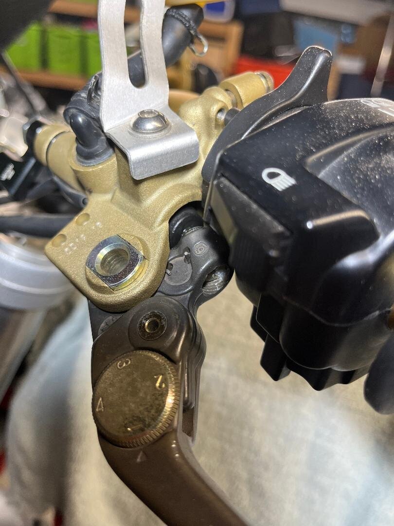

deadpen69 Posted July 10, 2023 Posted July 10, 2023 I was in the process of greasing the front U joint and inspecting bearings when I hit this snag. The bike is on a center stand on a lift with the swing arm removed. I even went so far as to carefully separate the perch from the bars and manipulate the whole thing so any bubbles had an opportunity to rise without letting the reservoir t draw air. I don't know why the PO glued the screw?? I can't imagine the MC just decided to poop the bed at the very instant I tried to maintenance it. I really have 2 choices. Figure it out or burn the garage down. I'm going to sleep on it. 1
docc Posted July 10, 2023 Author Posted July 10, 2023 Is there a wee spring indexing that plunger screw? (The tips of which are seen on the upper side of the lever through the two holes):

deadpen69 Posted July 10, 2023 Posted July 10, 2023 The spring is present. Note the glue or epoxy in the screw slot? I assume I want to be able to adjust this?
