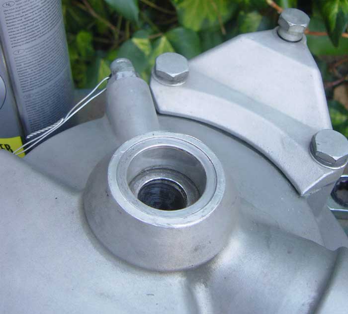

Paul Minnaert Posted November 12, 2008 Share Posted November 12, 2008 The inner ring from the right hand reardrive bearing wasn't looking so fresh. So I went to the shop and got the needle bearing, INA HK2516-2rs and the inner ring IR20x25x18 The last one is out of the INA catalog, but the chineese are helpfull, and make it. http://www.ikosh.net/gunzhen-zhoucheng/LRT...02518-3945.html The inner ring is the expensive part, so German parts are cheaper then Chineese. :-) On the right the old inner ring. The new one doesn't have a hole, so the grease stays maybe a bit more where it should. Next is the task to get the old one out, hopefully without taking the whole thing in pieces. To be continued Link to comment Share on other sites More sharing options...

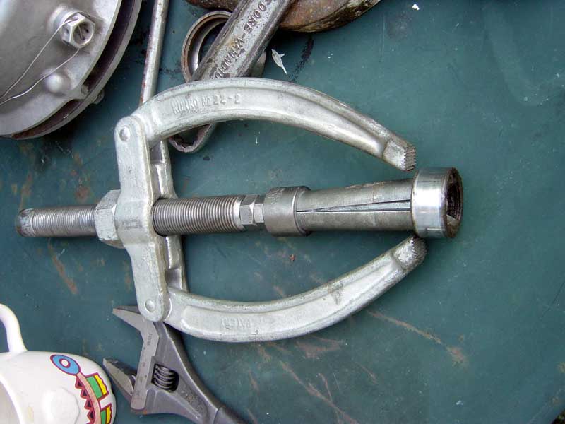

pete roper Posted November 12, 2008 Share Posted November 12, 2008 This is the bearing the bevelbox swings on? Worry no more! The expanding puller used for the needle rollers in the old five speed gearbox works just dandy. Guess how I know? I'm sure you know someone who has such a thing? If not if you can turn it around quick I'll lend you mine. Buggered if I know why the Guzzi bearing has an 'ole in it? To let water in and cause rust I suppose! On Nige's bike I couldn't get a bearing with a 17mm (?) race so I went for an 18 instead and then used a spare race from a five speed thrust bearing off the clustershaft as an excluder. When the whole thing clamps up it makes no difference as the bearing is a 2RS type, (SO why the hole to let shit in???) and if you honestly worry about a 1mm offset in the wheel you can either take it out at the swingarm or, as I did, simply believe that tyres aren't THAT precise! Pete Link to comment Share on other sites More sharing options...

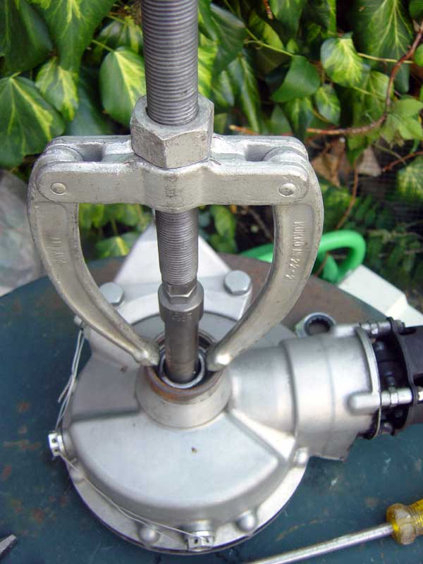

Paul Minnaert Posted November 12, 2008 Author Share Posted November 12, 2008 thanks Pete, but I think this tool I got today at work should be able to do it. I do remember discussions, but it was some time ago so freshen things up a bit. Link to comment Share on other sites More sharing options...

grossohc Posted November 13, 2008 Share Posted November 13, 2008 thanks Pete, but I think this tool I got today at work should be able to do it. I do remember discussions, but it was some time ago so freshen things up a bit. I have the same tool, it will take all of 30 seconds to pull the bearing with it, just make sure you catch it on the end of the bearing and not the lip on the wheel. Link to comment Share on other sites More sharing options...

Paul Minnaert Posted November 13, 2008 Author Share Posted November 13, 2008 well today it had to be done. first picture, its halfway out second picture, I wonder why they put in such a small bearing, instead of a sealed bigger one. third picture, to get it nice in, I heated the alu around it, and added an inner race from another bearing on the wheel spindle, the spindle makes it go straight in. And well, thats were the hammer was for. But wondering about how it comes that the grease doesn't stay there, I think the inner race doesn't need a hole. That only lets the grease out. When driving the reardrive gets hot, just like the bearing grease. Then that gets fluid, and the hole lets it out. So it have to look for a grease that does like heat. Link to comment Share on other sites More sharing options...
