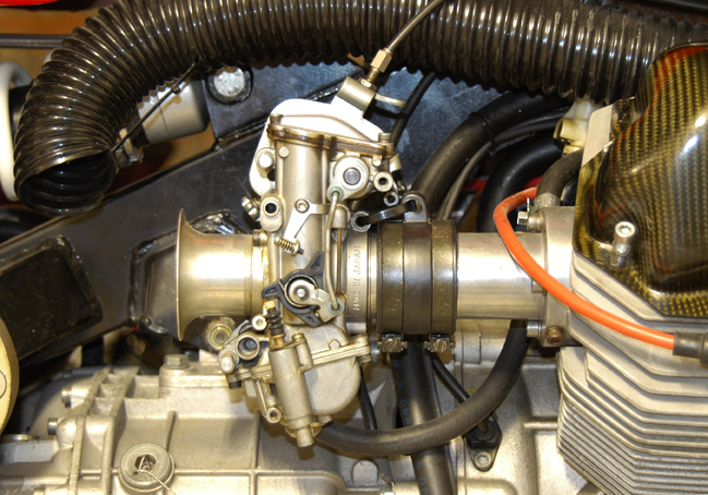

jcbooghs Posted December 22, 2008 Posted December 22, 2008 As pictures tell, I notice FCR's on Mr Pete Hindley 's bike! Maybe he raced Mikuni's as well, don't know. I have swapped my Dell Orto's to Mikuni TMR about 10 years ago. BIG difference! A true improvement. Much smoother, much shorter, much better. I've tried some Keihin FCR 41 as well. Very comparable. But in those day's the Keihin's weren't available with choke. And as I was still riding the streets those days I wanted some choke. In that case there wasn't much to choose from. There were also those huge and fat RS carbs. But they just spilled fuel, the slides shattered louder than the engine. I wasn't very charmed with that. So I went for the Mikuni TMR 40. That newer roller beared flat slide carb is a much better choice than the HSR. They do exist now in 41 too. Some info on the net http://www.supermoto-racing.de/content/ver...mikuni_tmr.html http://www.mikuni-topham.de/ http://www.allensperformance.co.uk/

Murray Posted December 22, 2008 Posted December 22, 2008 The FCR's are brillant IMO I've never missed the choke ethier Mukuni's I have heard can be a bit tricky to setup but thats more rumour and innuendo than direct experince.
