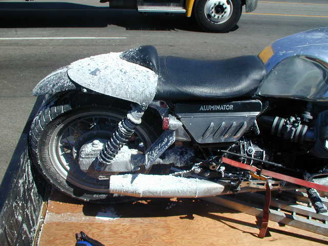

Guest ratchethack Posted December 22, 2008 Posted December 22, 2008 Felix, Mark Etheridge and the boys at Moto Guzzi Classics up in Long Beach http://www.motoguzziclassics.com/MGCContact1.asp have been foolin' around with an Aluminum for I don't know how many years. Mark claims to have hit 120 with it at Bonneville. Mark's a good guy. If you give him a call I'm sure he could answer any Q's. Have fun. The Aluminator, well salted
