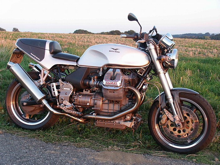

motoguzznix Posted January 28, 2009 Posted January 28, 2009 Here is a german Cantauro Conversio. All done by the owner Dirk including the Tank manufacturing. Dirks Website The company V2 Moto in Berlin/Germany has built some V11 with Centauro engine.

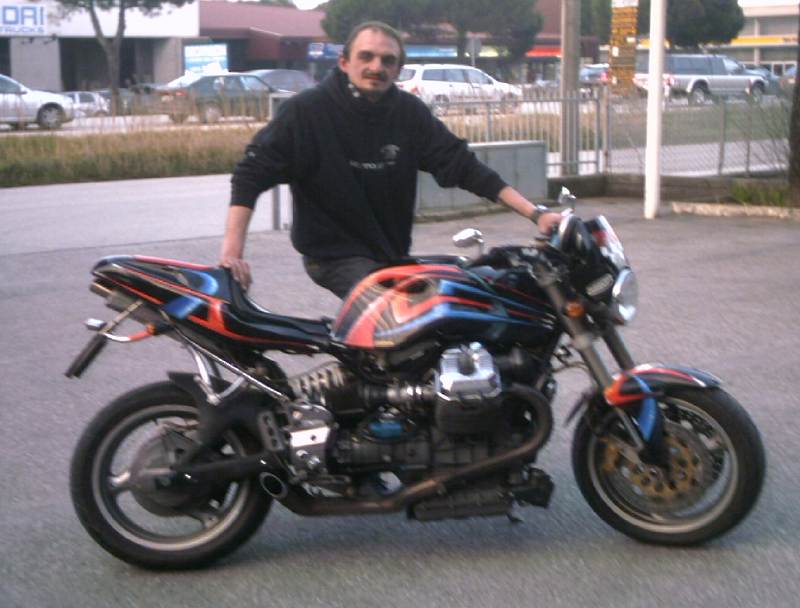

1100sport Posted January 29, 2009 Author Posted January 29, 2009 This one looks like a centauro fitted with a V11 tank and a 916 styled rear end. Really ugly paintwork but "to each his own"...
