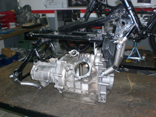

1100sport Posted January 29, 2009 Author Posted January 29, 2009 Nice bike! I see that you kept the OEM rear frame but fitted an "Australia" type rear bodywork (like Paul!) am I correct? How do you like the engine in comparison to the Aprilia? This was a Daytona once..now its work in progressIts into pieces now because im fitting a Ohlins radial front end from a RSV Factory now
mille108 Posted January 29, 2009 Posted January 29, 2009 Here is some more info on the bike Daytona special The bike came with that seat unit on it,it will have to go together with the subframe replaced by some thing more sleeker. Now im replacing the front end for ohlins,injection system for 42 flatslide carb's,swingarm for a aluminium one..ect ect we start again on the bike next week and wil keep u posted on the other topic. Compared to my (tuned)Aprilia track bike the bike is slow,no revs,no power..but thats not importand.. its a Guzzi

mille108 Posted February 15, 2009 Posted February 15, 2009 The guzzi is in progress now.. aka bits.. The injection system is so complicated..not on the technical side but the amount of wires,hoses,relays,pump,filter,sensors..just too much She ran fine with the injection on it but i believe that a guzzi engine(especially the 4v) should be bare.. so i decided just for the looks .to remove the complete system.. still dont regret it. now installing a Sachse ignition unit to get it going again with the carbs,later on that wil be replaced by a different unit Sachse

mille108 Posted February 20, 2009 Posted February 20, 2009 Hi there,just found this topic while searching for information. As I´m currently fitting a daytona tank to a centauro I do know that it fits nicely on to the main frame. Only I am not sure about the position of the front adapters. Are the ones on a Daytona frame slightly deeper? The tank seems to be a bit high at its front end. Can someone help me? Width of the adapters is perfect though. Anyone knows about the original rear end adapters for the early type tank and a suitable filler cap? As for a suitable seat, I made up a rear frame from a crashed v11 part, making looks a bit shorter. Second feature I could use some help with is the colour scheme for tank and seat cover. Black/White, Red/Black, Guzzi V8 old-style green with brown leather-seat? Can´t make up my mind. Any suggestions? Gerhard As far as i know the position is the same...i lowered the adapters to get the tank lower. Not easy though, because then the breather pipe on top of the frame has to be modified also. nice project
