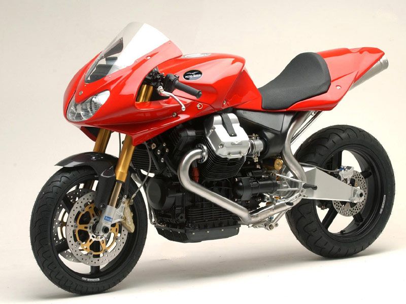

biesel Posted March 11, 2009 Posted March 11, 2009 nice ... Moto Guzzi MGS-01 Strada Luca Bar: Bar-Design ... more images
tikkanen Posted March 11, 2009 Posted March 11, 2009 Not bad, not bad at all.... Thanks for the tip, Jan! Cheers Søren
stockport claret Posted March 11, 2009 Posted March 11, 2009 Think I'll ring my dealer and ask about delivery
biesel Posted March 11, 2009 Author Posted March 11, 2009 Maybe somebody should hack the Moto Guzzi Website and upload it there.
Murray Posted March 11, 2009 Posted March 11, 2009 What the hell have they done!! ok so its a photo chump but jebesus the only reason it looks half reasonable is because the orginal was so stunning in the first place. You couldn't use that swing arm with the newer motor tranny combination, why not fit the aplira lenardo headlight into the mesh grill like it was desinged too rather than bashing the headlights into the fairing. For that matter why does it have a RS4V tail rather than the MGS one why has the silver bit in the front garud carried over fron the grsio where it works to a bike it has no obious pourpose. Why aren't the front indicators integrated with the mirrors like on the RSV aprilia. Petal disks are out of place too IMO and the red belly pan can disappear without a trace with no great loss. But what would I know about design I'm only a potential customer .

helicopterjim R.I.P. Posted March 12, 2009 Posted March 12, 2009 Much better But what about the brakes?
Paul Minnaert Posted March 12, 2009 Posted March 12, 2009 well this was the first prototype, with old style aprilia forks. They brake the same, I had them. Look the v11 oil cooler they mounted. Why didn't you use the original cooler jim? But without thermostat the engine will be under temperature most of the time. The oil pan is the v11 one but with the mgs they left out the thermostat. Should be easy to put back in.
