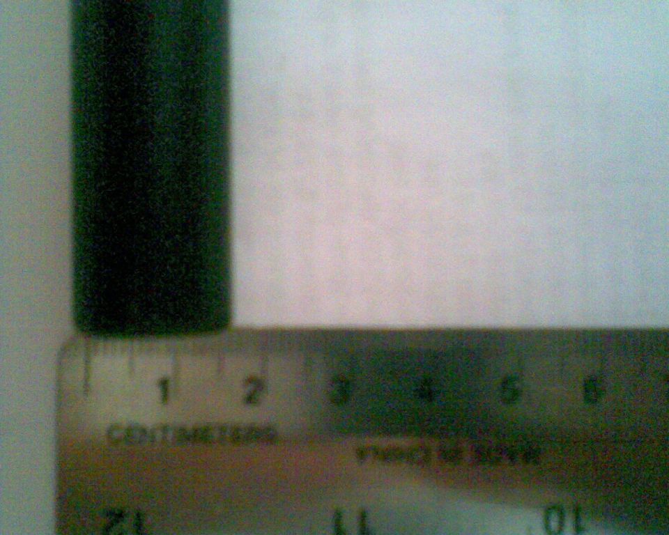

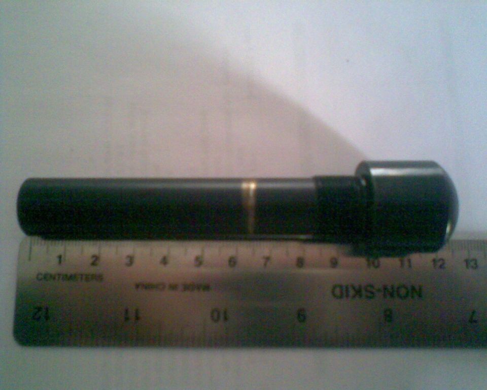

Bubb Posted March 23, 2009 Author Posted March 23, 2009 I think that type needs the TMs for 8mm inner bar diameter. Measure the plug thing. Okay so I yanked the plug out again and took a poor quality pic with my phone as I seem to have lost my camera in my last move. I measured the end of the rod and it came out to be 16mm and I was able to look up into the bar end and the rod butts up against a soild piece so I took the pics hope they help a little.
Bubb Posted March 23, 2009 Author Posted March 23, 2009 Okay so I yanked the plug out again and took a poor quality pic with my phone as I seem to have lost my camera in my last move. I measured the end of the rod and it came out to be 16mm and I was able to look up into the bar end and the rod butts up against a soild piece so I took the pics hope they help a little. Here are the pics I was finally able to shrink them down.I just hope this works.
Greg Field Posted March 24, 2009 Posted March 24, 2009 I made a typo. I meant for 18mm i.d. on the bars. Yours looks to be just under 18mm. See if TM will swap them out.
