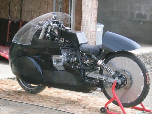

chasdom Posted April 1, 2009 Posted April 1, 2009 As a former owner of three V11 series bikes, I'm just wondering if anyone out there has done any 'gearing up' on their V 11 or other 'large block' Guzzi. My reason is that I'm presently working on a prototype for a fairing I've developed which is an improvement (with full lock-to-lock) steering capability, upon the dustbin fairings of the 1950's, but I erred in using a small block Nevada, for which gearing options are near zero. I have used a circa 1980 rear-end off I believe what was one of the old V50's, and also a 21" rear tire, but my rpm is still far too high for the power reduction allowed by the fairing. So if anyone has experimented with gearing on the bike block bikes, I'd love to hear from you. Also, has anyone out there ever lengthened a driveline and housing? Would love to know. Oh, if you're curious, you can see what I'm up to at my personal project page at toytotransportationcom my goal is to have a practical 100mpg full-sized bike. Thanks for your time, Best Wishes, Charles

chasdom Posted April 4, 2009 Author Posted April 4, 2009 By coincidence I know the guy who is selling this: http://cgi.ebay.co.uk/Moto-Guzzi-special-d...A1%7C240%3A1318 Hey 'Guzzirider" thanks very much for the link, but by the time I got to it Friday it was gone, thanks again, Charles
chasdom Posted April 4, 2009 Author Posted April 4, 2009 Hey Raz, thank you a bazillion, as you are a wealth of information, or at least a wealth of possibilities... now I have LOTS more research, but at least a few ideas to perhaps ask the right questions - thanks again, Charles
chasdom Posted April 4, 2009 Author Posted April 4, 2009 Hey "JC" thanks very much for the encouragement. Also, I checked out your link, and my compiments on your shop as it's first rate. Tell me- did anyone see what kind of bikes are the escourts for our P. Obama llimosine as he spins around your neighborhood...? It would be nice if they were Guzzi's, but I suppose they're Beemers, which is fine. I just hope he didn't haul some Hardley's over the pond! Again, best wishes, and I do hope all is well in Belgium.
chasdom Posted April 6, 2009 Author Posted April 6, 2009 Hi Chris thanks for getting me the primary ratios on the small blocks. you're idea of actually just "swapping" gear boxes is an intriguing one - if they're compatible with the later model Nevada, and also doing some back of the envelope math to see how much "taller' that would get me. As to the 'Baja", it sounds like a 'fix' with an added set of problems. Although to date on the project - every time I do something to this bike, it's like Newton's third law of physics ... they're ALWAYS a reaction in the form of a NEWLY created problem! Oh... to have the resources to be able to start from scratch... Oh, I had no idea Guzzi ever even made a "Baja" ... that's great. Coincidentally I had one of the 'orignal' Bajas, that is back in 1971 I bought a brand new Harley Davidson (Aermacchi) 100cc Baja. Sold it about ten years ago as it was literally out in the barn for a couple hundred bucks. Probably a mistake. Although a friend told me he saw one in the area - most probably my old one - so maybe I should go buy it back. It would probably make a fun little cafe racer. Oh well - again, thank you for the good info. and I will check it out. Chaz Charles , the gearing on the small blocks is altered by changing the primary gear sets .these are the two gears that are between the clutch housing and the gears per se.The final drive 's are all the same I think as are the gearbox ratio's. The slines on the shafts vary according to the vintage so a partial sawp may not be feasable. If you look in Guzziology , chapter 14-11 to 14 15 covers all the small block gearing options . They are as follows 13/24 for v 35 13/23 for v 35 imola and gt 12/24 v35 111. ntx and early tt 12/25 late tt and ntx 13/24 350 nevada 14/23 v 50, v50111 and custom 15/22 v50 monza 15/22 monza 11, v75, v65 , sp, custom, gt and florida 16/21 v65 lario, florida,750 targa, nevada 750 and 750 sp 14/23v65 tt and ntx The easiest way to go would be to simply swap the gearbox for one with the desired ratio and as the boxes are pretty cheap and available second hand( at least here in europe) that would be a cheaper solution than getting a big block and starting all over again ! another way to go is also to adapt a big block swinging arm to the sb frame which is the option the factory took with the Baja desert racer- They only hand built 17 or so of theses and the swinging arm mounting points on the gearbox were a constant failiure point in the design so they grafted on the big block one. I'd say that the larger and stronger UJ was also a consideration as they are known to fail dramatically in the small blocks and especially on the enduro models as the swinging arm is more steeply angled due to the longer shocks. I have a few baja pics if you are interested Chris
chasdom Posted April 6, 2009 Author Posted April 6, 2009 Hey Chris, I went and pulled up the page from Guzziology on the small block gearing and unless I'm being a "blockhead" which is entirely possible as sometimes gear ratios seem counterintuitive to me - when I take into account primary, high gear, final drive etc... it's almost like looking in a mirror with a mirror. I can be a wee bit slow! Anyway, just a cursory review suggests to me that the bike is already geared about as high as the small blocks go. I did add a slightly higher speed final-drive from a 500 (I don't recall the exact model offhand) that was about twenty years old, and I got an additional six percent. I also had laced (Buchanon Spoke and Rim) 21" front rim to the back wheel, and then covered it with disks - for an additional six percent or so. Still, I probably may just have to go to the big motor and transmission.
