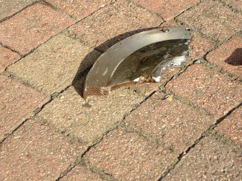

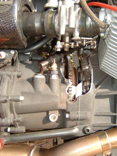

Admin Jaap Posted October 19, 2003 Posted October 19, 2003 Cause unknown, rider is okay. He told me that if your clutch starts to rattle more than usual or makes clunky noises, open it's guts and check! After this damage the german owner is so fed up with it, he'll take offers on the complete bike as is ('02 Scura) or parts. (Sorry Paul) Contact him here: rolandweinberger@t-online.de

Paul Minnaert Posted October 19, 2003 Posted October 19, 2003 He was on the road with 180km/h when clutch parts were thown out, next to his legs. He wasn't hurt. bike is from july 2002, 12.500km old....

zebulon Posted October 20, 2003 Posted October 20, 2003 This poor guy not alone. One of my friend had nearly the same trouble with his scura 02. The clutch brake and damage the gearbox casing but not the engine. By chance he was riding slowly & don't hurt. Guzzi replace complete gearbox + clutch . To my knowledge Guzzi has now stopped to put some single disk clutch on the special / limited editions. By the way he also have since the first days with his scura : 1 time gearbox leaking , 2 times gearbox spring broken , 1 time rear join crankcase leaking so a new clutch , 1 time clutc brake so new gearbox , clutch ... another time gearbox spring broken with new gearbox , that's all now :-(( He bought a Le Mans III after this and Guzzi make him an offer to replace the bike by a new one for a reasonable price
