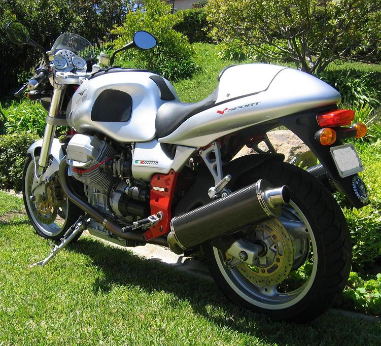

Front-to-Rear Weight Bias of the 2000 Guzzi Sport
FWIW, here's wot I came up with, from a post nearly 3 years back. Had to look it up myself because I couldn't remember.
Measurements were made one wheel at a time, with wheels blocked up even and level.
Here's wot I found:
DISCLAIMER: I weigh 180 lbs without riding gear. Measurements were made without riding gear. My Guzzi is a slightly modified 2000 Sport. The most significant mods likely to affect front-rear weight bias are replacement of stock mufflers with FBF carbons, and a list o' such trifling matters as the addition of a Stucchi flyscreen, Throttlemeister 14 oz. bar-ends, a smattering of extra relays and heavy gauge wire, a set o' Fiamm Highway Blaster horns, a Stucchi crossover, Roper plate, etc. The latter items I consider negligible to the exercise. Measurements were made with a half-tank of fuel. Laden readings were taken in riding position, as would be the case when taking suspension sag measurements.
534 lbs. = unladen
714 lbs. = laden
47/53 = F/R % unladen bias
42/58 = F/R % laden bias
This^ was actually not as bad as I had expected.
Coupla observations:
While both the total weight and the weight bias of the V11 design (either taken alone, IMHO), take the Guzzi Sport OUT of the category of modern, nimble-handling Sport machines of today, (some would say it's pretty far out, regardless) It's not all that far out, IMHO.
Raising the bars would shift the laden weight bias rearward - potentially a significant amount.
Heavier riders than myself would shift the laden weight bias rearward, and lighter riders than myself would shift the bias forward relative to the numbers I got.
Ciao. :helmet:
Config. as weighed

I have an enquiring mind, so I would like to know... :D
If a heavier rider shifts the weight rearward, why would a rider that weighs less shift the weight forward? Given the riders sit on the bike in the same way the weight should always head in the same direction shouldnt it?
Guest ratchethack
Good Q, Richard.
On the V11, the rider's weight, regardless of number, is always going to center aft of the center of weight of the bike, as the laden vs. unladen scale numbers indicated.
My observation above was based on this measurement. To take an exaggerated hypothetical as an example -- by extrapolating from the numbers I got, if a rider weighed half of my weight -- 90 lbs. (somewhere, I reckon there is one :huh: ), the laden F/R weight bias would be very close to 45/55 %.
Not too shabby, eh? ;)

Ok rh , can you tell me where you judged the center line to be and from where did u measure , I have access to a set of scales at work and I'd like to check my bike for a comparison, although I won't have to block wheels as the scale is built into the floor.
