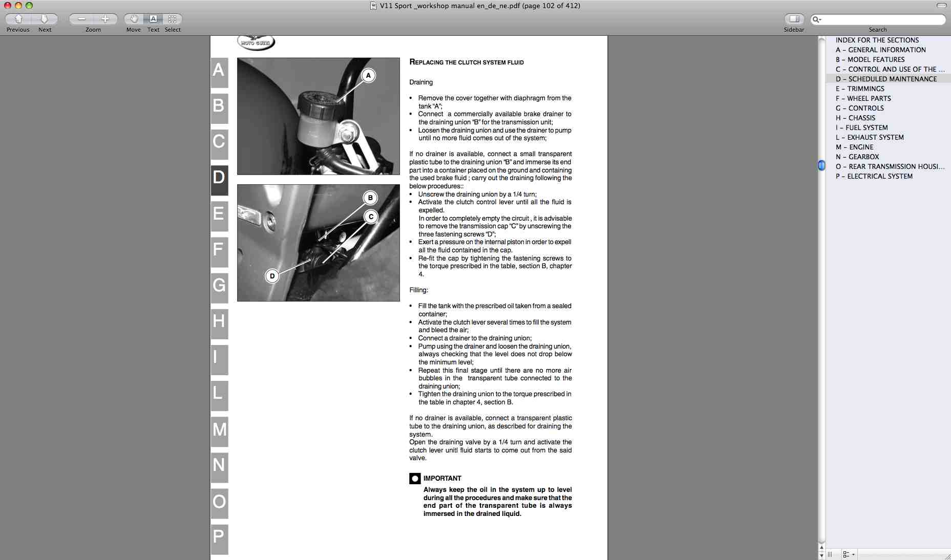

Did you try:
- Exert a pressure on the internal piston in order to expell
all the fluid (or air) contained in the cap.
Good luck with it.

On 5/24/2009 at 6:43 AM, guzzipete said:
Did you try:
Good luck with it.
