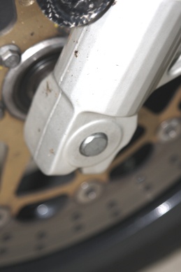

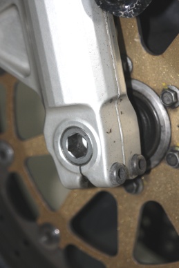

Baldini Posted June 22, 2009 Posted June 22, 2009 tmcafe, you have Ohlins forks? Mine look like this. Yours are different?
Guest ratchethack Posted June 22, 2009 Posted June 22, 2009 tmcafe, you have Ohlins forks? Mine look like this. Yours are different? Hm. This would explain a few things, and would seem to match up with the photo in his avatar. And yet, he mentions a spindle nut, and this fork doesn't use one. . .
tmcafe Posted June 22, 2009 Author Posted June 22, 2009 tmcafe, you have Ohlins forks? Mine look like this. Yours are different?Thanks Baldini and RH. Yes Ohlins stock but mines are diff though: 30 mm nut and washer instead of the Allen, and those two slots on edge of opposite wider end whereas yours seems to thread into right fork bottom. Four pinch bolts two per fork where yours has one set on right. There was a pic of that kind of axle maybe I ll find it. Might be common with Ducati. Also if you find a large pic of a Coppa (the official pics of the Cafe don't seem to show the axle nut setup on mine!--typical Luigi) you may be able to discern the large axle nut on the right fork bottom. As for the through hole RH mentions it can't be used for torquing as it's further in where axle is inside fork bottom.
