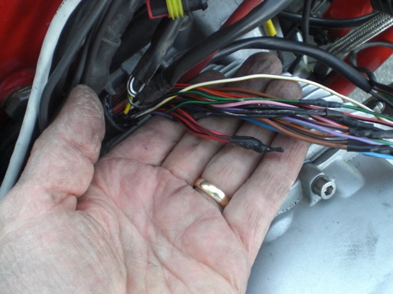

Kiwi_Roy Posted May 17, 2010 Share Posted May 17, 2010 I had the same experience plus the tacho and lights went dead. Voltage was anything between 9.8 and 18.6 V. The culprit was a loose connection at relay base under relay n:o 2. Roy has posted an excellent pic of how you remedy that. Not a hitch afterwords (knocks on head, err wood). Ok, I spent the best part of the weekend tracking down the problem (Intermittent tacho failure), this was a "Red Herring" I put small lamps across the 12V +/- terminals of the tacho and regulator +reference to ground, these never flickered even when the tacho stopped working. Measuring the battery voltage at the terminal posts I found it was jumping around anything from 10.5 - 13 with the tacho dropping to zero each time it was low. Conclusion - it's the regulator, this has been my gut feeling all along but in the meantime I have been over the whole bike and fixed up a few loose connections and potential trouble spots so the time wasn't wasted. I was amazed that the bike will still crank over with battery voltage as low as 10.5 volts, I bought a new one last year and treated it well all winter but i'm starting to wonder if just one cell is bad. Roy Link to comment Share on other sites More sharing options...

Kiwi_Roy Posted May 17, 2010 Share Posted May 17, 2010 Where would you tie in a voltguage If you are mounting it at the instrument panel I think I would jumper it onto the back of the tacho or with one of the panel lights, that way it will be protected by a fuse. Without the headlight loading down the circuit you shouldn't have any voltage drop. Another spot would be the ignition switch wiring. The problem with using an ammeter would be the long leads back to the battery area (unless you use a shunt and mV meter), perhaps under the seat to pick up all but the starter circuit. that would eliminate a couple of the wires on battery post. I have the Yuasa battery from B&I (USA) new last fall. I drilled the hole in lead terminal right through so I could add a decent length bolt. I'm going to have a crack at building my own regulator, there doesn't seem to be a reliable one out there so I can't do much worse. I did some preliminary testing and I think there is more power available in the low rev range than what the stock regs are putting out. The regulator is a pretty critical item, especially on a trip away there's no reason they should be failing like that. Roy Link to comment Share on other sites More sharing options...
