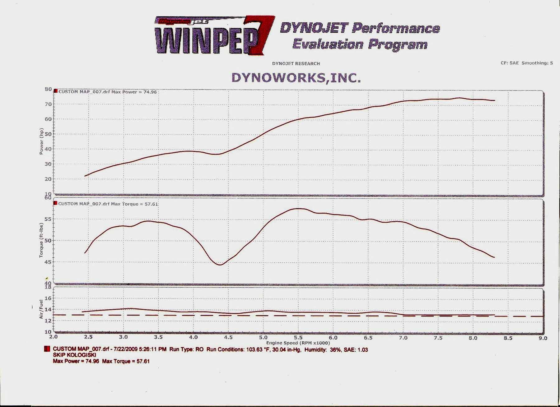

Karl Von Posted July 27, 2009 Author Posted July 27, 2009 Well got the Rosso back from the tuners today and what a diffrence. He said the bike was running way to lean. It idles great now and does not bog down at 4500 rpm. There is a little surging around 3500 to 4000 but you only notice it if you keep the throttle there for a long time. The bike rides like a guzzi now !! I have attached the dyno run.

Guest ratchethack Posted July 27, 2009 Posted July 27, 2009 Wot foto said^. That's one wicked 10 lb-ft hole in the torque curve at 4400 RPM. You've actually got more torque at 2400 RPM than at 4400. A decent crossover would help fill that in, and give you more midrange punch right where you really need it on the road. A Stucchi worked well for me.

Tom M Posted July 28, 2009 Posted July 28, 2009 Glad to see the bike running better but yikes, that's a massive torque dip at 4500. Based on my experience you will see a gain in torque and lose the 4500rpm dip by just adding an aftermarket crossover. The previous owner of my bike had a custom map done. I added an FBF crossover later, and recently did a dyno run with no changes to the map. You can see the improvement in the torque curve. Dyno charts are here: http://www.v11lemans.com/forums/index.php?...st&p=161148 Does the bike idle for more than 30 seconds now? If so what solved that problem?
