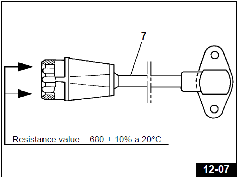

raz Posted August 22, 2009 Posted August 22, 2009 The resistance test is with sensor disconnected from bike. There is a three pin plug somewhere up along the cable: But Luhbo's test is better: If the pump runs a little time more after you stop cranking, or if you by other means detect that it does run during cranking, then this sensor is OK.
renato Posted August 22, 2009 Author Posted August 22, 2009 The resistance test is with sensor disconnected from bike. There is a three pin plug somewhere up along the cable: But Luhbo's test is better: If the pump runs a little time more after you stop cranking, or if you by other means detect that it does run during cranking, then this sensor is OK. ill check that, thankx
renato Posted August 29, 2009 Author Posted August 29, 2009 The resistance test is with sensor disconnected from bike. There is a three pin plug somewhere up along the cable: But Luhbo's test is better: If the pump runs a little time more after you stop cranking, or if you by other means detect that it does run during cranking, then this sensor is OK. hey, got some time and checked the phase sensor by cranking the motor and the fuel pump did not prime after cranking, so i removed it and it was swollen like may be burnt out, tested it got nothing on the meter, purchased a new one installed it and got that great sound out of my cut down mistrals that i love to hear, thankx to all for all your help
