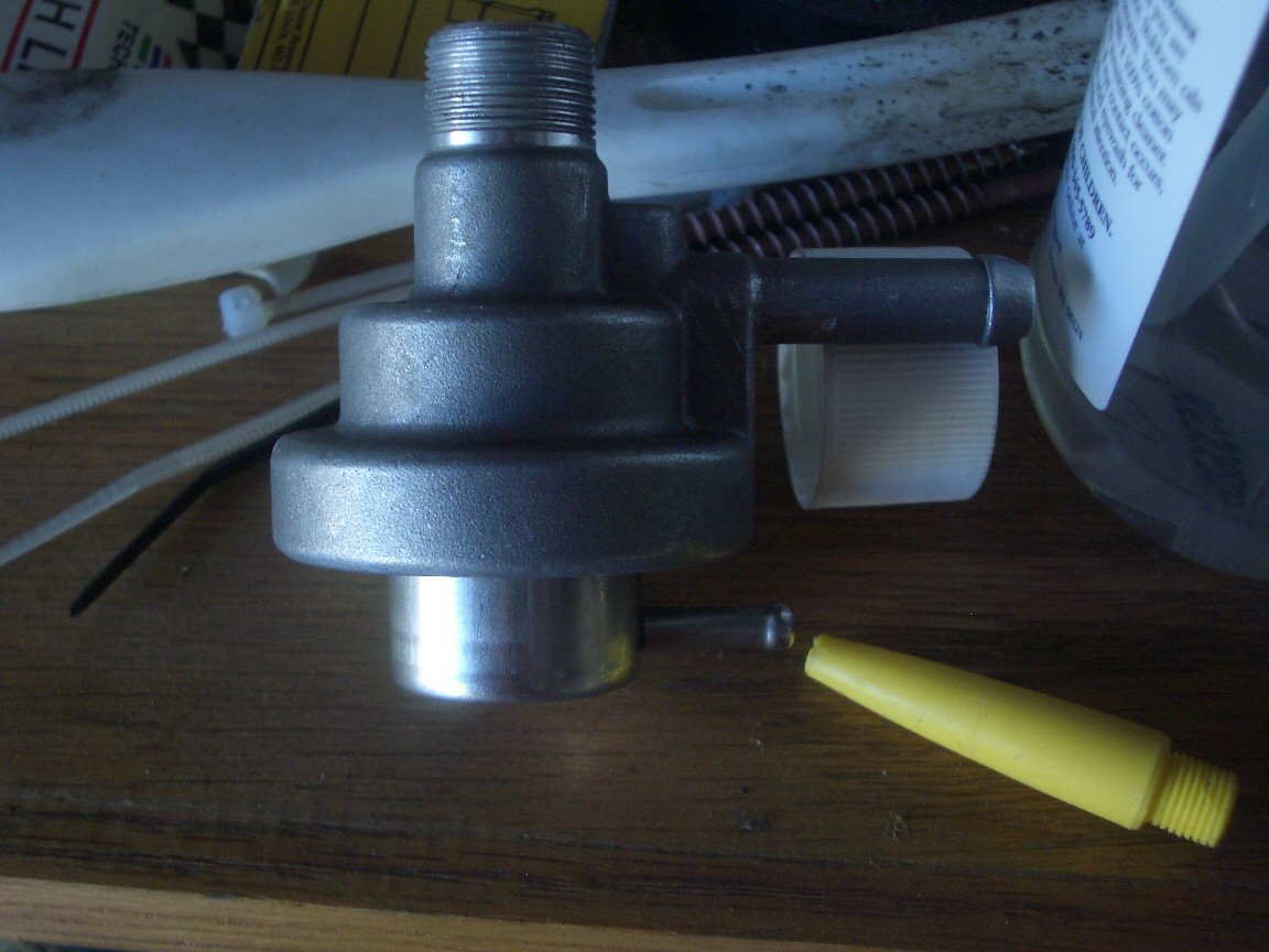

Bbennett Posted August 27, 2009 Author Posted August 27, 2009 That's a good suggestion (the reflective tape is peeling off big time uder the tank) but I have cylindrical K&N air filters. I like the suggestion in that I have checked everything in the fuel system at this point - 1 item at a time. No joy. My thoughts now wander to air intake and god help me - electrical. I guess I could remove the PC-III to see what would happen - it has been on there for 5 yrs. **Edit: tried that - no impact** The problem is progressive. I can no longer get the bike up more than a 10 degree hill and am effectively garage bound. Except for my Aprilia. But that is a monster to ride, espec in this heat. Bob P.S. The little nipple at the bottom of the fuel regulator (yellow thing is pointing at it) is not supposed to have a line on it is it? And I assume that fact that the bottom the fuel regulator with said nipple rotates a little is not relevant...
