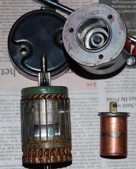

vuzzi Posted December 10, 2009 Posted December 10, 2009 Vuzzi,May not be your problem,but I solved my symptoms by CLEANING my solenoid. Just be careful not to ground neg wire from battery to ECU when removing it.that's what fried my original solenoid when replacing original ECU to MG Ti ECU. http://www.v11lemans.com/forums/index.php?...c=13958&hl= I took the starter off. Checked all the wires to the starter and starter relay. they seemed OK. I put 12 V on the sollenoid using an old and weak battery, and the plunger quite strongly pulled the bendix forward. Put 12 V on the starter engine, and it rotated nicely, though not as fast as i might have expected. Then took the starter apart. The sollenoid was slightly black and greasy at some points which easy to whipe off. The black and grease was not in a way that it would have made it hard to move, however, could if have some effect on electric properties? I noticed some wear of the copper layer of the plunger. Anybody knows if that can do any harm over time? After geasing some of the rotating parts I reinstaled the whole thing and it starter as never before. Still not 100% sure that caused the slow cranking, but happy enough do be driving again.
