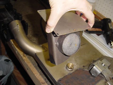

OldButNotDead Posted November 3, 2009 Posted November 3, 2009 Don't know if you've got the same iteration as me, but mine's on the bench at the moment...here's a plate I riveted in place of the cat: And here's the cat: Hope that helps.
arek Posted November 3, 2009 Author Posted November 3, 2009 Don't know if you've got the same iteration as me, but mine's on the bench at the moment...here's a plate I riveted in place of the cat: And here's the cat: Hope that helps. Thanks for the photos ... I do not have this plate, but rather it is one solid design. (I would have to take it off the bike to take a pic) Also, I think we have different iteration of this exhaust, because I have the QD ink print, where as your QD is pressed. I will not chop it up myself as I have never welded in my life ... but if I can find a trusted welder who would be willing to work with me on this I would. But this leads to another question - is it possible and would it help to increase power to insert another outlet on the other side of the exhaust? I guess no one has done this, and there is no data or know how to support this. hmmm... Anyone can recommend a welder in San Diego county
