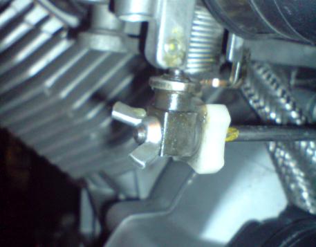

docc Posted November 3, 2009 Share Posted November 3, 2009 There is more than one procedure that includes the RHS set screw. I've done it both ways over these 69,000 miles and find the "defeat" method much simpler and just as reliable. I do use a jam nut on the white knob and, yes, you must be diligent to keep it from moving the knob as it's tightened. FWIW, my white knob rotates on threads, making the rod shorter or longer while the right side of the rod stays soundly anchored with its lock nut. I should have read Ratch's post more closely, but I'm understanding his white knob stays "affixed" and his rod length must be adjusted from the right(?). Good news there is you surely wouldn't need a jam nut on the left! Link to comment Share on other sites More sharing options...
Guest ratchethack Posted November 3, 2009 Share Posted November 3, 2009 I should have read Ratch's post more closely, but I'm understanding his white knob stays "affixed" and his rod length must be adjusted from the right(?). Good news there is you surely wouldn't need a jam nut on the left! You read it right, Docc. It's frozen solid. If it ever gets loose, I'll be securing it with JB Weld or a locknut, whichever -- just to ensure it stays in synch. Link to comment Share on other sites More sharing options...
Greybeard Posted November 3, 2009 Author Share Posted November 3, 2009 And I owe RH a 1/2 apology. My white knob is NOT moving on the threads as it surely should be! It will be when I get back to it, but right now it's frozen solid as well. This will never do. Link to comment Share on other sites More sharing options...
docc Posted November 4, 2009 Share Posted November 4, 2009 Maybe a little BreakFree CLP or some-such to get the little bugger spinning. A tiny 8mm hex nut secures the knob nicely but keep it secure in the locking process just like you would a valve adjuster. Link to comment Share on other sites More sharing options...
raz Posted November 4, 2009 Share Posted November 4, 2009 A tiny 8mm hex nut secures the knob nicely but keep it secure in the locking process just like you would a valve adjuster. Depending on where you have free threads you can put the lock nut on the inside or the outside. I had it on the outside. Regardless of my trying to keep it secure when I locked it, it altered sync significantly because the plastic deformed in some way. I'll try relocating the threads (using RH side) so I can put a lock nut on the inside, that should cause no interference. You gotta love wing nuts on motorcycles Link to comment Share on other sites More sharing options...
docc Posted November 5, 2009 Share Posted November 5, 2009 Looks like my 2000 Sport is configured a bit differently with the nylon knob on the outside. Link to comment Share on other sites More sharing options...
Dan M Posted November 5, 2009 Share Posted November 5, 2009 Looks like my 2000 Sport is configured a bit differently with the nylon knob on the outside. Same set up on my 02, sans lock nut. I find the nylon thumb wheel stiff on the threads so no lock nut necessary. Perhaps they loosen up with age & adjustment? Link to comment Share on other sites More sharing options...
docc Posted November 5, 2009 Share Posted November 5, 2009 Hey! Who you callin' aged and out of adjustment? Link to comment Share on other sites More sharing options...
