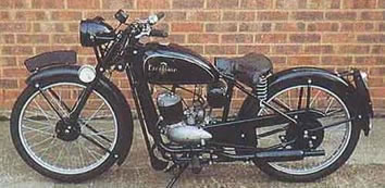

Now if we were measuring the suspension spring rates from a '51 Excelsior (which I once owned), and comparing rates with a '57 Trabant (which I've never even seen) and running rate calcs with any of the common and relatively consistent rate calculators on the Web today, all bets would be off on the concept of a same-same spring rate calculator comparo.
But o' course, that's just me. ^_^
