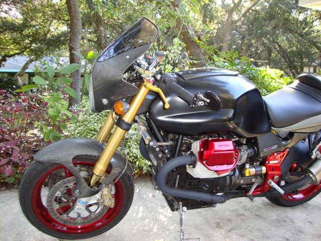

richard100t Posted January 3, 2010 Share Posted January 3, 2010 I noticed a recent picture from a forum member with a Scura that had the rims and valve covers powder coated in the candy red Rosso Mandello color. At least I'm pretty sure it was powder coating. I think it was posted in the pics thread and they look perfect. I believe he had the stock rims but since powder coating involves baking the powder at 400 degrees f. I dont think you should have any problems with your forged rims. Link to comment Share on other sites More sharing options...
richard100t Posted January 3, 2010 Share Posted January 3, 2010 here it is Link to comment Share on other sites More sharing options...
