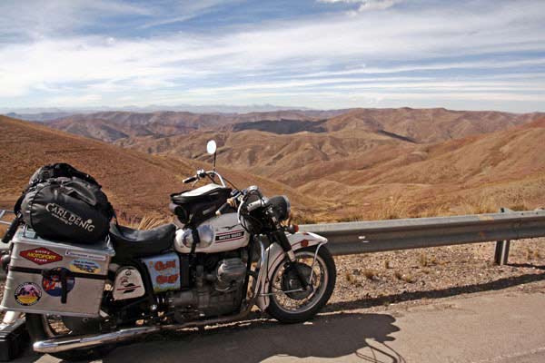

Here's a shot of the top secret prototype that led to the development of your 2011. This shot was taken shortly after Mr Terblanche was dragged out to a remote location in the background and left with a carbon fiber seat cover for shelter.
I like it! Did you just centre the longer steering stem in the shorter loop frame neck? Or did you have to favor the top (or bottom) to deal with any fender to generator cover or frame clearance issues? That front wheel is standout, I cant believe they didnt continue to use that rim on the current retro spokers.
That's my friend Paul's V7. I put a bunch of work into it when he stopped in Seattle on his way to South America.
