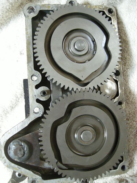

mznyc Posted August 20, 2010 Posted August 20, 2010 Why did mine look like this when I opened it up? No fluid on gears like Gary's,fluid was in window before I changed it,..
Tom M Posted August 20, 2010 Posted August 20, 2010 Why did mine look like this when I opened it up? No fluid on gears like Gary's,fluid was in window before I changed it,.. He used Redline Shockproof Heavy. It really sticks to everything.
belfastguzzi Posted August 25, 2010 Posted August 25, 2010 Why did mine look like this when I opened it up? There are at least three different versions of the 'inside bits', which is why I was interested to see Gary's interesting find. Some of us have got the racing box Gary has the heavy duty, reinforced, touring & ploughing box.
