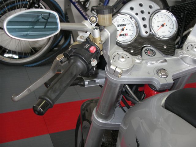

Dan M Posted March 4, 2010 Posted March 4, 2010 Quick hijack. Bob, Those mirrors, Rizoma Dynamic? How is the view? I'm considering them for my Aprilia but am worried about the small size. Thanks, back to idle adjustment now.
ponti_33609 Posted March 4, 2010 Posted March 4, 2010 Those mirrors, Rizoma Dynamic? Yes Dan, Rizoma Dynamic mirrors. Funny........the Mickey Mouse ears are MUCH larger but vibrate so much on my bike you couldn't see anything......the Rizoma's are smaller but for whatever reason, do not vibrate so I can see. It only took me a couple days to get use to the size difference. BAck when I bought PJ's was the only guy......seem to be more carriers in the states now. Bob
