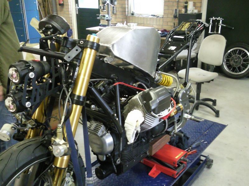

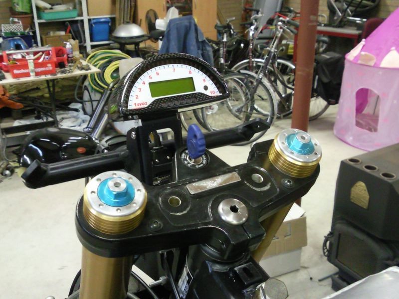

FalcoLion Posted April 25, 2010 Posted April 25, 2010 On 4/23/2010 at 7:17 AM, Admin Jaap said: After some consideration, I'm sticking with my Guzzi Ti pipes. I have ordered the speedo. Also quite expensive, but the OEM dash just doesn't go with the modern looks of the kit! And it's so cool to have a lap timer. (where's the poser smilie?) I haven't installed the clipons yet, but from what I can see, they have to be mounted under the triple tee. Don't think risers will work. Oh, what maybe important to you: Forget long distances! The tank is very small. I guestimate about 7 to 8 liters... Yes that is pretty small gas tank. I am also curious why did you take off the drive shaft. It looks like a straight bolt on of rear subframe, front/instrument cluster subframe and then putting plastic and the headlight. Also curious about your rims. Did you get these with the kit as well? I agree on the speedometer. It definitely will upgrade/modernize the look of the bike and will be a perfect fit cosmetically. Does this speedo uses OEM sensors or do you have to do it from the scratch? Thank you for your answers

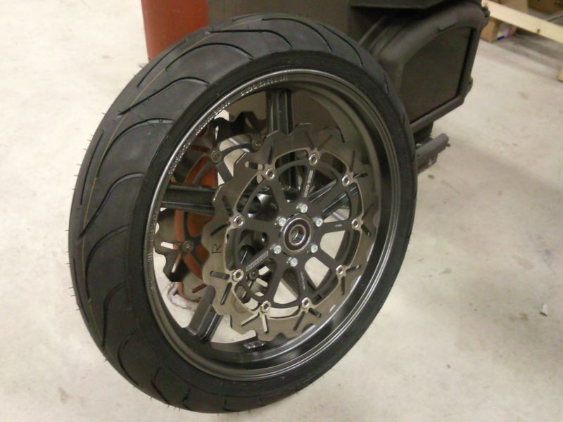

Admin Jaap Posted April 25, 2010 Author Posted April 25, 2010 The wheels are only mounted to move the bike on the bike lift. I have to take them off again to mount the rotors. The bevel box is off because I want to modify it (the big flange (?) is coming off). The rims are G&B and are from a Furia. I already bought them 5 or 6 years ago, so they're not included in the kit. The speedo is electrical (pick up on the front disc) and the rev counter works like OEM I think. If you have more questions, ask away! The kit's build quality is definetly top notch. All fasteners are included and labeled (handy!)

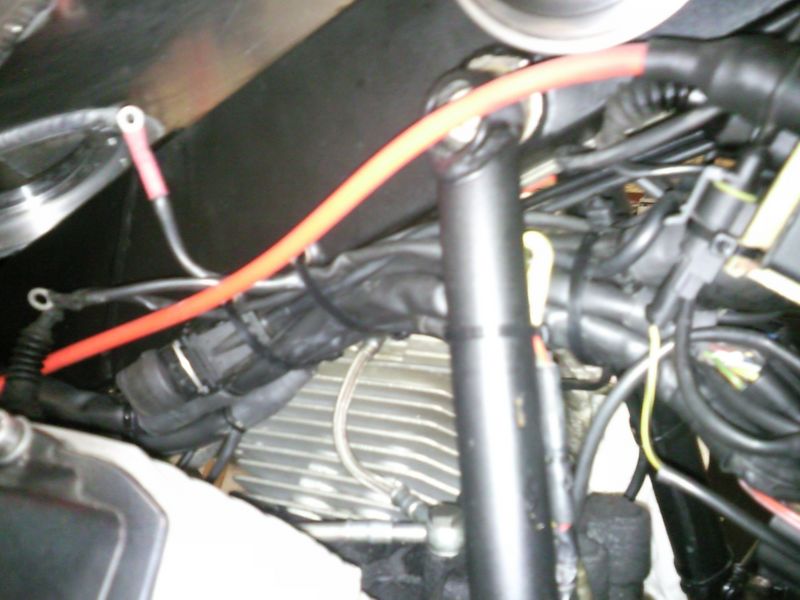

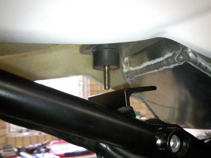

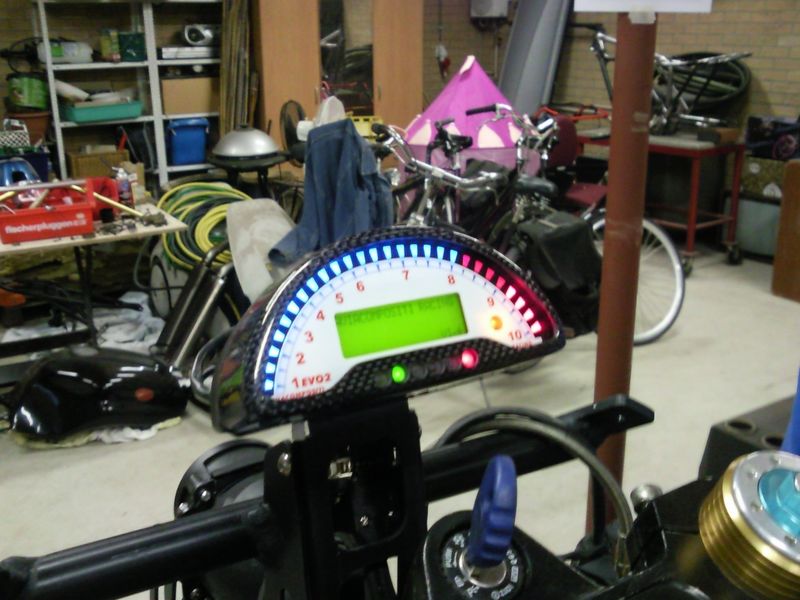

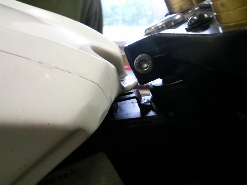

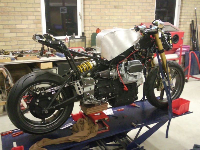

Admin Jaap Posted May 3, 2010 Author Posted May 3, 2010 When I was celebrating the queen's birthday (and recovering from it...) my brother did a lot of work on the bike's electrics. Rerouting the cables, mounting the fairing frame with headlights, cleaning the engine and lots more! It was quite a surprise when I visited yesterday to watch the MotoGP. Fitting is not exact, but easy to fix Great dash with lap timer!
raz Posted May 3, 2010 Posted May 3, 2010 Nice work! And nice brother. Why is none of my brothers like that? <_>

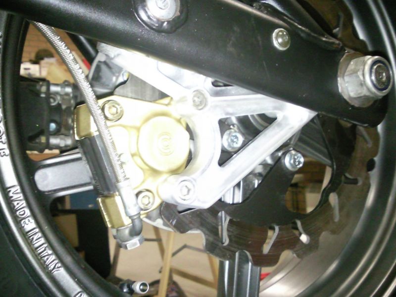

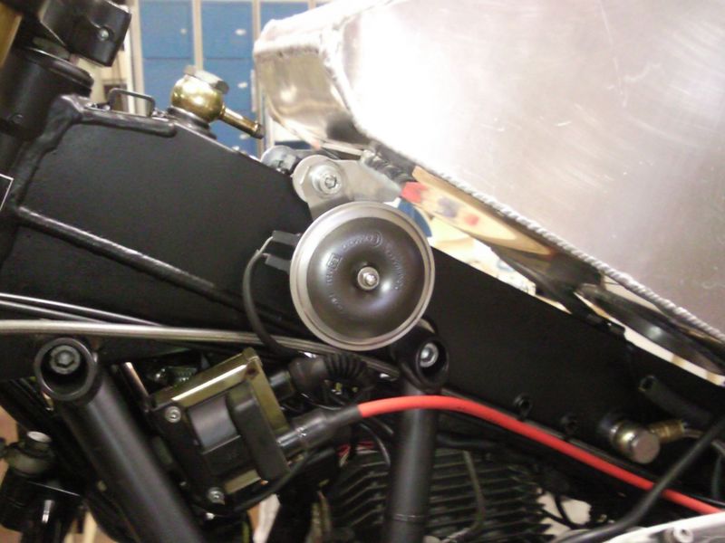

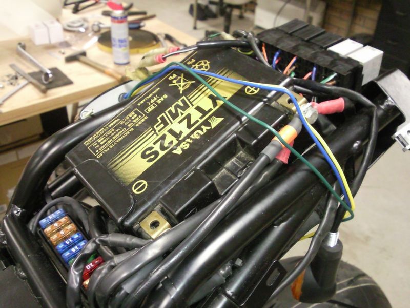

Admin Jaap Posted May 8, 2010 Author Posted May 8, 2010 A lot of work done: Horns are placed so that they are not in sight Removed coating from rear brake mount and added some holes to make it look less heavy. Battery, fuse box and relais fit nicely in the subframe Looks great even w/o the bodywork! Yeah it works! Lap times and lots of other info can be downloaded to a PC Wiring loom is tucked away nicely under the spine
Guzzirider Posted May 8, 2010 Posted May 8, 2010 You are doing a great job there Jaap! How easy was the instrument unit to install?
Admin Jaap Posted May 8, 2010 Author Posted May 8, 2010 My brother installed it. He didn't complain, so I guess it was plug-and-play!
Admin Jaap Posted May 11, 2010 Author Posted May 11, 2010 Swapped the rotors from my 1200Sport. The G&B now has three Braking wave discs.
